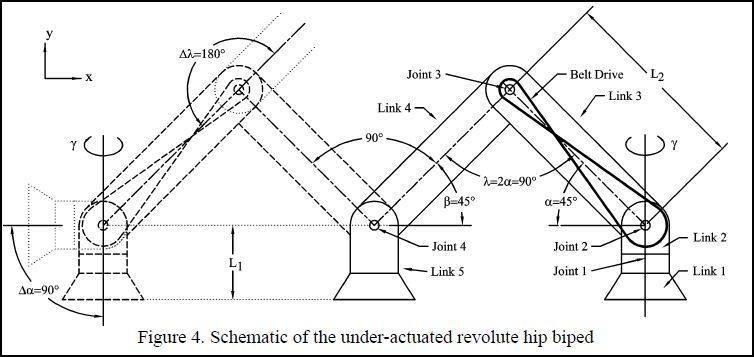

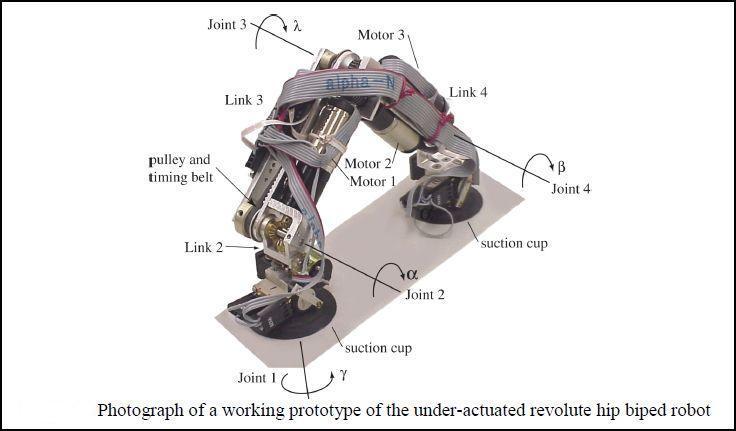

To design linkeges of wall climbing robot
awakash
pls guide me in designing of linkeges of climbot
can someone answer my query
