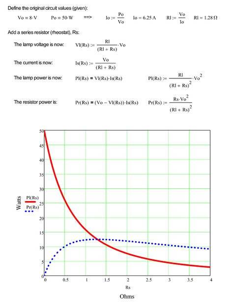

Your rheostat will get hot (≤12.5W, in this case). It will also be kind of expensive. So, I would try a dimmer on the AC source first.
However, the algebra is pretty simple to define what you would get, as shown below.

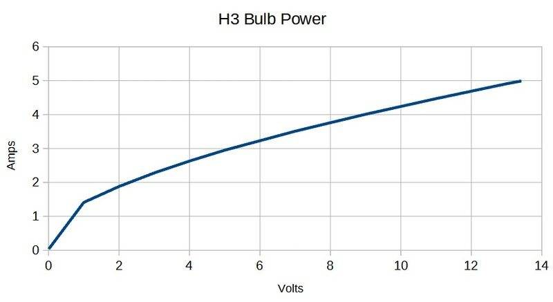

I found an H3 halogen bulb in my junk box, and could not resist measuring the current vs voltage. The plot is below:
The current is proportional to the square root of the voltage. That relationship is within about 2% for over 6 volts. It glows red at 4 volts, and starts making useful light at 6 volts. I would size a rheostat for your bulb as follows:

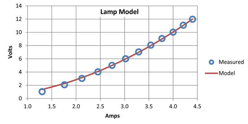

I measured the 12V, 50W halogen lamp in my microscope (not the 8V flavor the OP has). The square law model works well, which makes sense since I'd expect the filament resistance to vary (mostly) linearly with temperature, but the temperature should vary as the square of the voltage. My model included a small series resistance for the leads*, since I couldn't actually measure just the filament. For my setup V = 0.545⋅I2 + 0.33⋅I fit very well, <1% error from 4 to 12V.

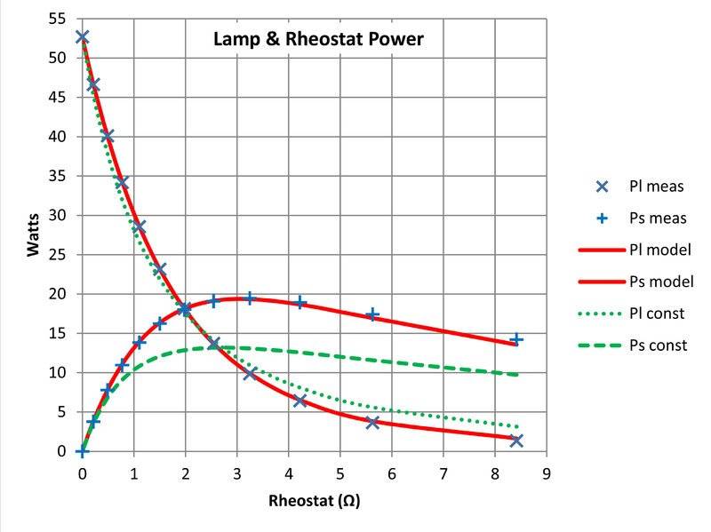

Then I modeled the rheostat dimmer comparing the constant resistance model (post #4) with the non-linear model and found much more power in the series resistor in the non-linear model; 19W versus 13W (max.).

* edit: 0.33 ohms is way too much for just the lead length in my setup, which was more like 0.02 ohms or so. So this is mostly from the filament deviation from the square law.
Excel said V = 0.4658I2 + 0.883I - 0.9104 was the best fit.
