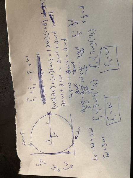

The cylinder of weight W is shown in the following diagram. The coefficient of static friction for all surfaces is ⅓. The applied force P = 2W.
I am working on number 11. Find the distance d for which counterclockwise motion is initiated by P.
T = F r
I got d = ½ r but that is not an answer choice. Can someone else try this and tell me what you got?
