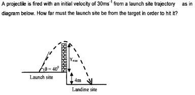

Given: a platform which is 4m high. On the edge of it is a brick wall with height Y. The launch site is some way behind the wall. The landing site is past the wall and beyond the platform. The launch angle is 40 degrees. Find the range.

Could you provide the exact wording of the question please?
Here's another stab at it:
Y=30 sin 40=19.28m

Therefore the launch site needs to be 105.02m away from the target in order to hit it.
Does this seem correct to you?
I still don't understand the problem. Where is the target? Anywhere on the other side of the wall or are you tring to maximize distance from the wall? Minimize it?
If the wall is some arbitrary height,Y, I would think the final answer would not be purely numerical answer but expressed in terms of Y.
I have absolutely no idea, I'm afraid. As far as I'm concerned, it's 105.02m away. :p
