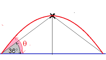

"Upon spotting an insect on a twig overhanging water, an archer fish squirts water drops at the insect to knock it into the water (Fig. 4-38). Although the fish sees the insect along a straight-line path at angle Φ and distance d, a drop must be launched at a different angle θ0 if its parabolic path is to intersect the insect. If Φ = 36.0° and d = 0.900 m, what launch angle θ0 is required for the drop to be at the top of the parabolic path when it reaches the insect?"
##y=(tanθ_0)x-\frac{gx^2}{2(v_0cosθ_0)^2}##
##R = \frac{v_0^2}{g}sin2θ_0##
##θ=36°##
##|d|=0.9m##
##\vec d = (0.728m)i+(0.529m)j##
##0.728m=\frac{v_0^2}{9.8\frac{m}{s^2}}sin72°##
##7.1344=v_0^2(sin72°)##
##v_0=2.335\frac{m}{s}##
##0.529m=(0.72812)(tanθ)-\frac{(9.8\frac{m}{s^2})(0.728m)^2}{2[(2.335\frac{m}{s})(cosθ°)]^2}sin72°##
##(-0.729)(sec^2θ)+(0.72812)tanθ-0.529=0##
##(-0.729)(tan^2θ+1)+(0.72812)tanθ-0.529=0##
##(-0.729)tan^2θ+(0.72812)tanθ-1.257=0##
Let:
##q=tanθ##
so:
##q^2-0.999q+1.724=0##
And then I come to an impasse at the 4ac>b2 block. I'm thinking I'm mistaking my R for my x... So how would I find R for v0?

Yes. A figure helps. What is y of the fly?
0.529 m...
I should really start drawing these pictures on my own, instead of trying to do these problems without one.
Eclair_de_XII said:
0.529 m...
Yes. :smile: So what is θ?

You can get the expression for x and the maximum y in therms of θ. What is their ratio?
No, I derived x and y from Φ, so it'll just give me 36° again.

you have x= ## \frac{v_0^2}{2g}sin2θ_0##. What is the maximum of the parabola? Substitute for x into the formula for y. the speed cancels if you take the ratio y/x.

Okay, I got it.
##\frac{y}{x}=tanθ-(\frac{g\frac{v_0^2}{g}sinθcosθ}{2v_0^2cos^2θ})=tanθ-\frac{sinθcosθ}{2cos^2θ}=tanθ-\frac{1}{2}tanθ##
##0.727=\frac{1}{2}tanθ##
##1.454=tanθ##
##θ=55.48°##
Geez, this was much harder than it looked.
