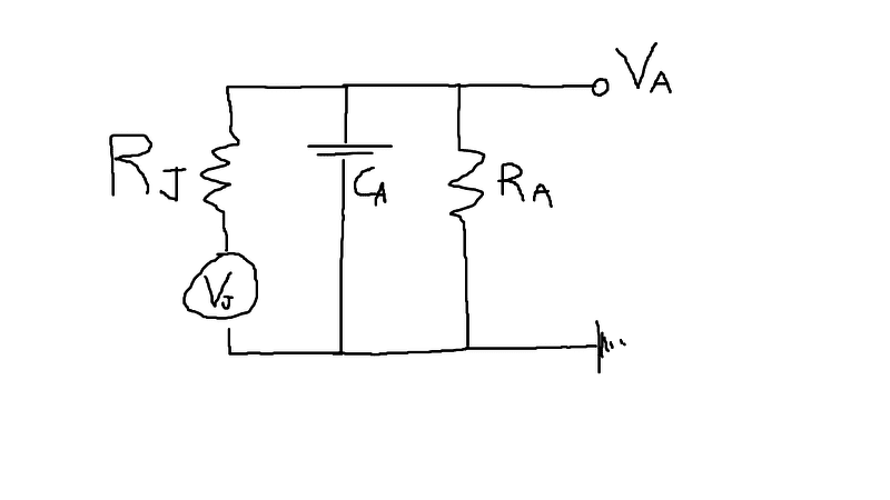

Transfer function of this simple circuit
The discussion focuses on calculating the transfer function |V_{A}/V_{J}| for a circuit involving resistors and capacitors. The user identifies that R_{A} and C_{A} are in parallel, leading to the equivalent impedance Z_{A}. The voltage across Z_{A} is expressed using the voltage divider rule, resulting in the formula for |V_{A}/V_{J}|. The final expression shows the relationship between the resistances and capacitance in the circuit. The calculations appear to be correct and satisfactory for the user's needs.

The picture of the circuit is attached; I want to find |V_{A}/V_{J}|. This seems really easy but I haven't done circuit analysis in forever.
Complex impedances, Z_{C} = 1/i\omega C, Z_{R} = R.
First R_{A} and C_{A} are in parallel, so the equivalent impedance is Z_{A} = Z_{C_{A}} Z_{R_{A}} /(Z_{C_{A}} + Z_{R_{A}}). Then the circuit is a voltage divider, so the voltage across Z_{A} is V_{A} = V_{J} Z_{A}/(Z_{A} + Z_{R_{J}}). Therefore,
\frac{V_{A}}{V_{J}} = \frac{Z_{A}}{Z_{A} + Z_{R_{J}}} = \frac{i R_{A}}{i(R_{A} + R_{J}) - C_{A} R_{A} R_{J} \omega} \implies \left| \frac{V_{A}}{V_{J}} \right| = \frac{R_{A}}{\sqrt{(R_{A} + R_{J})^2 + (C_{A} R_{A} R_{J} \omega)^2}}

Looks good.
Likes 1 person
Okey dokey, thank you!
