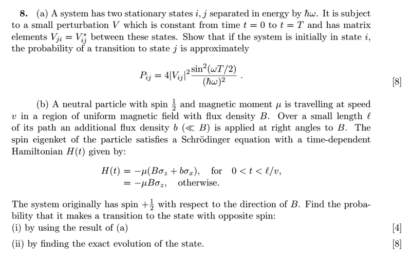

Typeset physics problem 8 with parts (a) and (b): a perturbation transition probability P_ij = 4|V_ij|^2 sin^2(wT/2)/(hw)^2, and a spin-half particle with Hamiltonian H(t) = -mu(B sigma_z + b sigma_x) for 0 < t < l/v.
Part (a): Show probability to transit from state i to j is given by:
Part (b)i: Use answer in part (a) to find probability
Part (b)ii: Use time evolution to find probability
Part (a) was alright, bookwork question on time dependent perturbation theory.
What's interesting was, I got different answers for part (b)i and (b)ii.

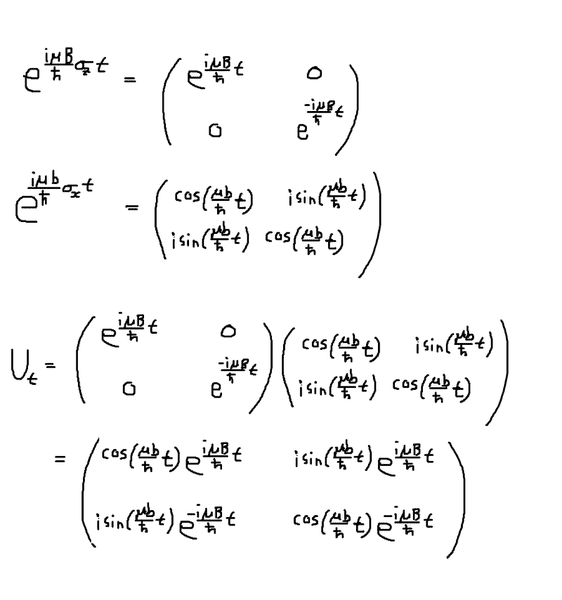

The time evolution operator is given by ##U_{(t)} = e^{-\frac{iH}{\hbar}t}## such that ##|\psi_t> = U_t |\psi_0>##.
To find the time evolution operator:
[tex]e^{-\frac{iH}{\hbar}t} = exp(\frac{i\mu B \sigma_z}{\hbar}t) exp(\frac{i\mu b \sigma_x}{\hbar}t)[/tex]
For each of the exponentials, I found them in matrix form:
Handwritten matrix derivation of the time evolution operator U_t as a product of two 2x2 matrices: a diagonal matrix with exponentials e^(i mu B t/hbar) and e^(-i mu B t/hbar), times a matrix of cos(mu b t/hbar) and i sin(mu b t/hbar) entries, giving the combined 2x2 result.
Now to overlap the desired |-,B> = (0 1) state with evolved state ##|\psi_t>##:
[tex]<-,B|\psi_t> = i sin (\frac{\mu b}{\hbar}t) exp(\frac{-i\mu B}{\hbar}t)[/tex]
Thus, probability is ##sin^2 (\frac{\mu b l}{\hbar v})##
Keeping in mind that ##\sigma_z## and ##\sigma_x## do not commute, is this correct?
I was thinking about that, as the original operator was: ##U = e^{-\frac{iH}{\hbar}t} = exp(\frac{i\mu B \sigma_z}{\hbar}t + \frac{i\mu b \sigma_x}{\hbar}t)##
Do I use ##\sigma_x \sigma_z## or ## \sigma_z \sigma_x##?
And is the answer to (b)i correct?

By the way, what's wrong with my method with the time evolution operator ##U_t## above?
I don't think the method is wrong, but you can't factor the time evolution operator as you did.

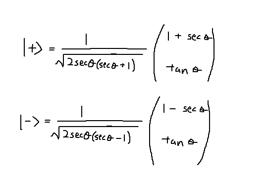

Yeah I got these two eigenstates:
Handwritten equations for two spin eigenstates: |+> equals 1 over sqrt(2 sec θ (sec θ + 1)) times a column vector with entries (1 + sec θ) and tan θ; |-> equals 1 over sqrt(2 sec θ (sec θ - 1)) times a column vector with entries (1 - sec θ) and tan θ.
At t = 0, the state of the particle is along z-axis, but we wish to express it in basis along net B field, B'.
[tex]|\psi_0\rangle = |+,z\rangle = a|+,B'\rangle + c|-,B'\rangle[/tex]
This implies that ##a = \langle+,B'|+,z\rangle = \frac{1}{\sqrt{2sec\theta(sec \theta + 1)}}(1+sec\theta) = \sqrt{\frac{1+cos\theta}{2}}## and ##c = \langle-,B'|+,z\rangle = \frac{1}{\sqrt{2sec\theta(sec\theta-1)}}(1-sec\theta) = -\sqrt{\frac{1-cos\theta}{2}}##
Handwritten equations for two spin states: |+> equals 1 over the square root of 2 sec θ (sec θ + 1), times a column vector with entries 1 + sec θ and tan θ; |-> equals 1 over the square root of 2 sec θ (sec θ - 1), times a column vector with entries 1 - sec θ and tan θ.
If you forget normalization for a moment, notice that ##|+,B'\rangle \sim \left(
\begin{array}{c}
1+\sec\theta\\
\tan\theta\\
\end{array}
\right)
\sim \left(
\begin{array}{c}
\cos\theta +1\\
\sin\theta\\
\end{array}
\right)
Use half-angle identities to express ##1+\cos\theta## and ##\sin\theta## in terms of ##\theta/2## and simplify.
