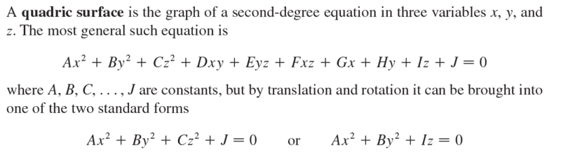

This is not homework. I try to study calculus by myself using James Stewart book and below is part of text that I want to ask about
Not sure
I want to ask how ##Ax^2+By^2+Cz^2+Dxy+Eyz+Fxz+Gx+Hy+Iz+J=0## can be brought to ##Ax^2+By^2+Cz^2+J=0## or ##Ax^2+By^2+Iz=0## using translation and rotation. There is no explanation in the book. What kind of translation and rotation are needed?
Thanks
(1) The constants in the various forms are not the same.
(2) The variables int he various forms are not the same.
The general form can be written [tex] \begin{pmatrix} x & y & z \end{pmatrix} \begin{pmatrix} A & \frac12D & \frac12 F \\ \frac12 D & B & \frac12 E \\ \frac12 F & \frac12 E & C \end{pmatrix} \begin{pmatrix} x \\y \\ z \end{pmatrix} + \begin{pmatrix} G & H & I \end{pmatrix} \begin{pmatrix} x \\ y \\ z \end{pmatrix} + J = \mathbf{x}^TM\mathbf{x} + \mathbf{b}^T \mathbf{x} + J = 0.[/tex] Now [itex]M[/itex] is symmetric, so its eigenvalues are real and it has a basis of orthogonal eigenvectors; thus there exists a rotation (ie. a matrix [itex]R[/itex] with determinant 1 such that [itex]R^{-1} = R^T[/itex]) such that [itex]R^{-1}MR[/itex] is diagonal. What happens if you now set [itex]\mathbf{x} = R\mathbf{X}[/itex] in the general form and complete the squares in each variable for which the corresponding diagonal entry of [itex]R^{-1}MR[/itex] is non-zero?

They took out that whole chapter? Nice! I remember *hating* that chapter. :oldruck:

I will try first and update what I have done.

Can you maybe tell me the name of the chapter or anything related to the transformation of quadric surface so I can learn the basic?

I sold that textbook back to the university's bookstore about thirty years ago. Sorry.
