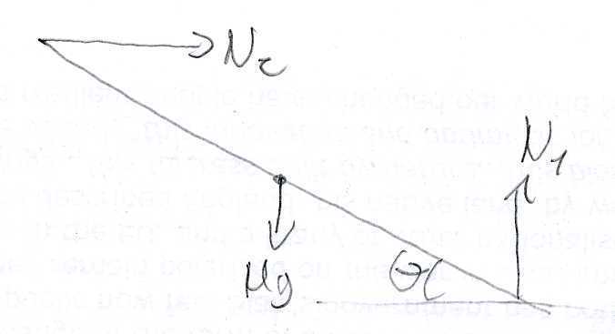

A plank of lengt 2l leans against a wall. It starts to slip downward without friction. Show that the top of the plank loses contact with the wall when it is at two-thirds of its initial height.
Hint: Only a single variable is needed to describe the system. Note the motion of the center of mass.

Draw a free body diagram.
You are finding the torque about which point?

Here is a FBD as I think it should be. In the diagram I also think that the normal forces are [tex]N_{1}=Mg\sin\theta[/tex] and [tex]N_{2}=Mg\cos\theta[/tex] where the latter might be most interesting. See my post below for further thoughts.
How did you determine this?

On closer thought I need to revise this to [tex]N_{2}=\frac{\sin\theta\cos\theta}{2}[/tex] where the trignonometric part is due to the force being applied perpendicular to the gravity force through the plank. The factor 2 is due to the normal force being at twice the length. I think this should be correct.

Yes, I needed the free body diagram to reevaluate the angular acceleration, and using that the horizontal acceleration should be zero I arrived at the equation [tex]-2\sin\theta+2\sin^{2}\theta-\cos^{2}\theta=-1[/tex] with the non-trivial solution [tex]\sin\theta=\frac{2}{3}[/tex] Thanks for help Doc!
Excellent! :approve: (A tricky problem indeed.)
