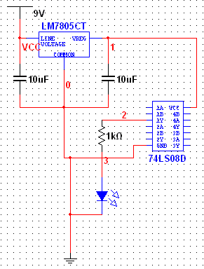

I'm not really new to Digital Electronics, but this is confusing the crap out of me. My school's started a DE class and at the moment we're getting all our equipment worked out and stuff, but for some reason NONE of our IC's work. We're using a 9-volt batter with a 7805 regulator for 5 volts out (measures up to about 4.2). When we connect the chips to the power, they go haywire. I'm mainly using a 7408 (Quad 2-AND) to test with, and it doesn't matter if A and B are high or low, Y is always high. It doesn't even matter if the chip is grounded, as long as VCC is high, there is an output. What gives?

Okay, here's exactly how I have it set up, just like is discribed on the datasheet. All components are placed nowhere near each other on the breadboard, but it STILL somehow lights up the LED. Brand new board, brand new 74LS08/74LS32.

Why do you have all those floating inputs? Ground pins 1 & 2 and the LED will go out. Has that been the problem all along? Unconnected inputs?
I drew it like that to make the my point, but...this Sorta solves it...if I use switches ground the pins then yeah the light is only on when both switches are Off...but isn't that a NAND, not an AND? I was under the impression that you had to bring A and B high for Y to be high, not ground them.

Check the direction of your LED on the board, and whether it is tied up to 5V or down to ground. And yes, an '08 is a Quad AND, and an '00 is a Quad NAND. Check which you have on the board, and check the polarity of the output versus the inputs. They should match the functionality of the part.
I've been working on this some more and I think that the problem Was that the pins weren't grounded. I went looking back through some learning books (which use 4000 series CMOS) I started out with, and they all use a Vcc PBNO Resistor Ground setup, with the A and B of the gate between the PB and resistor. This grounds the circuit if the button is open and provides current if not. This is something I never did when started using Multisim, because in its simulation, when the switch is open, it drops the voltage on the line to 0.
It would seem that the SPST switches that are in the work-stations are grounded on the Open side. On the class worksheets that we do, there is no diagram on of the switch parts, it is only a box labeled "Trainer Switch" with a single pin connected to A or B on the gate. This doesn't translate over to a normal breadboard very well, hence this whole problem.
