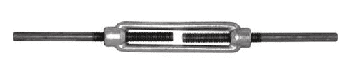

Turnbuckles have a right hand thread and a left hand thread.
That implies that if I pull from both ends, the turnbuckle will resist the tension because the inner body would need to twist both ways simultaneosly to become unscrewed. The same applies to the compression case.

I don't think that's right. If you twist the TB one way, it pulls both screws in, and visa-versa. So if it weren't for friction of the screw surfaces in the TB, tension would unwind the TB and the two ends would separate, no?
You're totally right. My description was incorrect. Additional locking measures are necessary to prevent the loss of preload.

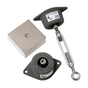

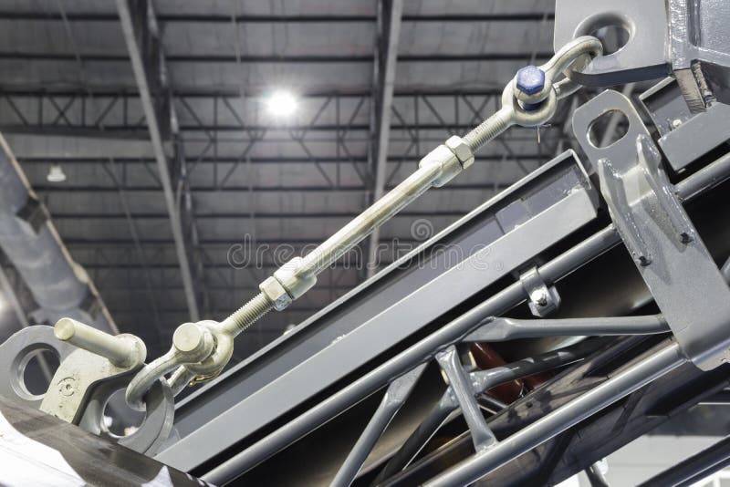

The types shown in the pictures are used for supporting heavy exhaust piping of internal combustion engines and for belt tensioners.
Note the counter-nuts and the flexible elements for control of vibration.
