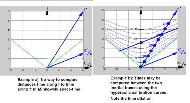

  • #41
bobc2 said:
bobc2 said:
Here's another example. The hyperbolic calibration curves were computed in MatLab.
Why in your first example do you call the hyperbola curve "Proper Distance" and in the second one "Proper Time"?

  • #47
The upper and lower cones (inside the cones) are normally referred to as "timelike" and the outside of the cone is referred to as "spacelike." Points on the cone sufrace are "lightlike."
The term "Proper Time" normally refers to measurements along world lines inside the light cone. I usually stick to that convention unless I am trying to emphasize the X4 distance along the 4th dimension in accordance with X4 = ct. Actually, some authors use units of spatial distance for Proper Time (usually with the greek tau symbol).
  • #48

  • #50
bobc2 said:
bobc2 said:
...look closely and you will see that I included that hyberbolic calibration curves so that we could make comparisons between the two coordinate systems. I used the 5 year calibration curves for each of the two inertial start events for the traveling twin.
I'm not understanding what these calibration curves are for or even how you derived them. On the bottom one, you show it going through the 5 year Proper Time for the traveling twin and through the 5 year Proper Time of the stationary twin.
Later you said:
bobc2 said:
My slanted lines were not meant to represent some standard space-time configuration. And, again, they were certainly not intended to be the planes of simultaneity shown in the sketch above (we had already discussed those more than once in this thread). Again, I just added them to the space-time diagram so you could follow the synchronous proper times of the twins.
Are you saying that you have a calibration scheme that allows you to determine that the twins have synchronized clocks or that it provides some means by which to "calibrate" them? It seems rather trivial to me if all you want to do is draw a line from a particular Proper Time for one twin to the same Proper Time for the other twin but then I don't understand why you would need a calibration curve.
  • #51
I'll add some more commentary a little later. For now, let me provide these sketches with a little bit of commentary.
Equation 1) is derived from the upper left sketch. We have sketched the space-time diagram for a red guy moving to the left and a blue guy moving to the right. Both red and blue are moving at the same speed with respect to the rest black system. This is necessary in order that line lengths on the screen for red and blue will have the same scaling (one inch along a red coordinate has the same physical value as one inch on the corresponding blue coordinate). If you don’t use symmetric coordinate systems in this way, you must use hyperbolic calibration curves to compare physical distances among coordinate systems. This is what we wish to make clear with the hyperbolic curve derivation accompanying the sketches.
These slanted coordinate systems arise from special relativity theory. These unusual looking coordinates are selected as the only coordinates that always yield the same speed for light: c. That’s because the world line of a photon of light always bisects the angle between the X4 coordinate and the X1 axis.
Note that the X4 axis for a moving observer is rotated with respect to the rest system X4 axis (the slope is proportional to the speed). Then, the moving observer’s X1 axis is rotated so as to always maintain symmetric rotation with respect to a photon world line (which is always rotated to a 45-degree angle in the rest system).
Now, we see that the blue X1 axis is perpendicular to the red X4 axis. You will find this is the situation for any pair of symmetric coordinate systems. Further you can always find a rest system for which observers moving relative to each other will move in opposite directions at the same speed. So, contrary to some objections, this derivation is not a special case—it has completely general application. This allows us to write the Pythagorean Theorem equation involving the red and blue coordinates. The time dilation Lorentz transformation equation can be derived directly from the Pythagorean Theorem.
Here, we just want to derive the Proper Time hyperbola equation, i.e., equation 2) above. This equation may be modified for time scaling, using X4 = ct (we use units of years for time and use the compatible units of light-years distance along the X1 axis as shown when plotting the graphs for equation 3).
Equation 4) is shown for a constant value of 10 for the Proper Time. See the corresponding plot. This plot shows the points along a hyperbolic curve in the black rest system that correspond to a fixed Proper Time value of 10 years. The red slanted lines terminating on the hyperbola represent example world lines (time axes) associated with possible observers moving at various speeds.
So, even though the line lengths on the computer screen are different in the rest black rectangular coordinate system, the Proper Times are all the same.

Bob, I appreciate the time you are spending on this. I can see now what your curve is.
But you can get the same curve using the Lorentz Transform by plugging in t=10 and x=0 and then sweeping β from +infinity to -infinity and plotting the locus of [t',x'] points. You are showing how a single event can transform into all possible frames.
But why? What has that got to do with anything?
Did you discover this on your own or can you point me to an on-line reference that explains this calibration curve and what its purpose is?

  • #54
But can't you give me a quick idea of why you do it? What are you calibrating? How do you use the curves once they are drawn?
Hi, ghwellsjr. Here is the short story. Example a) is a spacetime diagram with black rest frame and blue frame moving relative to rest frame. But you cannot compare times between the black frame and the blue frame. Example b) uses the hyperbolic calibration curves which allow you to compare times between t and t'. And you can see how much time dilation there is for the blue guy looking at a clock along black's world line (t axis). When blue's calendar says 30 years, he "sees" (correcting for light travel time, etc.) black's calendar showing about 26 years. You can measure the slope of blue's time axis to see how fast he is moving with respect to the black rest system.
By the way, notice that the X1 axis of blue is tangent to the hyperbolic curve at the time point of interest.
