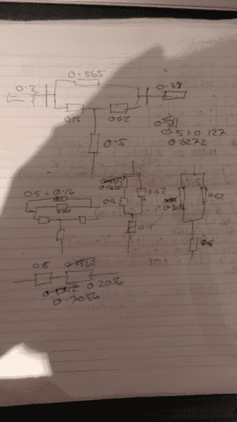

Bringitondown
Reduction from top network to bottom network in the screen shot. I can not find the steps that have been taken to do this.
Fault impedance = Zfa = Zfb = Zfc = j0.5
in hand written screenshot, sorry for the mess, just to show it has been attempted.
Looks like a Δ-Y transformation to me.
I have just realized i have not converted from cart to pol when calculating equivalent impedance.
doh, i think this may have been the problem
Yes, thanks will try again with this in mind.
thank you
tra
Transformation right enough, thanks for this.
