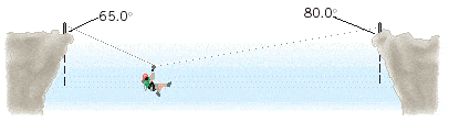

A mountain climber, in the process of crossing between two cliffs by a rope, pauses to rest. She weighs 514 N. As the drawing shows, she is closer to the left cliff than to the right cliff, with the result that the tensions in the left and right sides of the rope are not the same. Find the tensions in the rope (a) to the left and (b) to the right of the mountain climber.
The rope coming from the left is 65* below the edge of the cliff. The rope from the right is 80* below the edge of the cliff.(* denotes degree symbol)

Im not sure if I know the two basic rules or not to be honest. I'd love to learn them though so I can hopefully get through these sorts of problems in the future without assistance. I've attached the diagram that is given in the online assignment.

I think I may have figured it out, but I want to get someone to check it for me before I submit. After breaking the two tensions forces, which I'll call T1 and T2 from here, I was able to work out a solution.
ΣFx = T1cos(25) - T2cos(10) = ma
a = 0 m/s^2 so
ΣFx = T1cos(25) - T2cos(10) = 0
T1cos(25) = T2cos(10)
T1 = [cos(10)/cos(25)]T2
ΣFy = T1sin(25) - T2sin(10) - w = ma
a = 0 m/s^2
ΣFy = T1sin(25) + T2sin(10) -w = 0
T1sin(25) + T2sin(10) = w
[cos(10)/cos(25)]T2 * sin(25) + T2sin(10) = w
(0.9848/0.9063) * 0.4226T2 + 0.1736T2 = 514N
T2 = 812.171N
T1 = (0.9848/0.9063)(812.171N)
T1 = 882.571N
Does this all look correct? It's my only shot at full credit and I don't want math blunders or poor assumptions on my part to mess it up!
