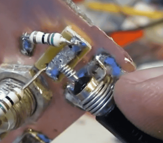

I have two words for you... "Z-Lead Probes" :smile:
(Oh, and that should be "For an N-turn coil"...
http://i.stack.imgur.com/cbLXI.png
Close-up photo of a circuit board with a resistor having brown, black and green bands, soldered joints and a finger holding a metal-tipped probe near a connector.
  • Close-up photo of a circuit board with a resistor having brown, black and green bands, soldered joints and a finger holding a metal-tipped probe near a connector.
@berkeman With the OP's sketch, the problem is not the leads.(It is because EMF's are being generated depending on how the wires are routed). This is a very good example of Professor Walter Lewin's paradox. Please see the video in post 52 of the "link" that I posted. Professor Walter Lewin explains it completely in his video.
