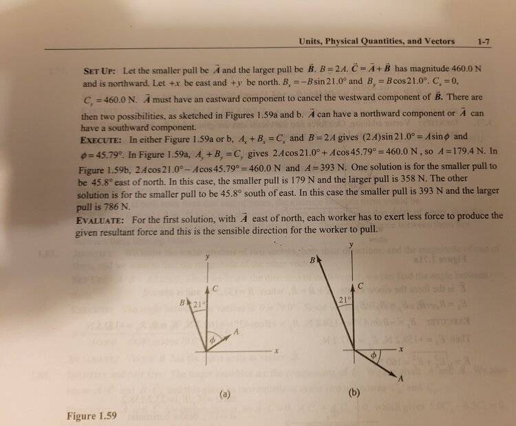

I am still having problems with this question. There is no diagram provided in the original question, however I have attached the diagram from the student solution manual. Continuing from my first post, I understand that one possible solution is ##\vec A## having a direction of ##45.8°## east of north.
For the case where ##\vec A## is in the fourth quadrant, I do not understand how they arrive at ##\phi = 45.8°## south of east. Should it not be ##\phi = 44.2°## south of east?
I think you are getting mixed up. If the Forces are in configuration (a) the solution is ## F @ 44.21^{\circ} \nearrow##.
If they are in configuration (b) ( A solution I didn't consider the first time) then ## F @ 45.78^{\circ} \searrow##.
For configuration (a), if we follow the given diagram, ##\phi=45.8°## and the angle between the initial side and the terminal arm of ##\vec A## is ##44.21°##. Is my understanding for this part correct?
Sorry, I didn't realize they had ## \phi## defined off of vertical like that... Yes for figure (a) ##\phi=45.8°##
Thank you for confirming. So for figure (b), they have ##\phi=45.8°##. As labeled in the diagram, should it not be ##\phi=44.2°##.?
Yeah, as they have it shown in (b) it should be ##\phi=44.2°##.

erobz said:
Yeah, as they have it shown in (b) it should be ##\phi=44.21°##.
Thank you! I thought I had done something wrong.
