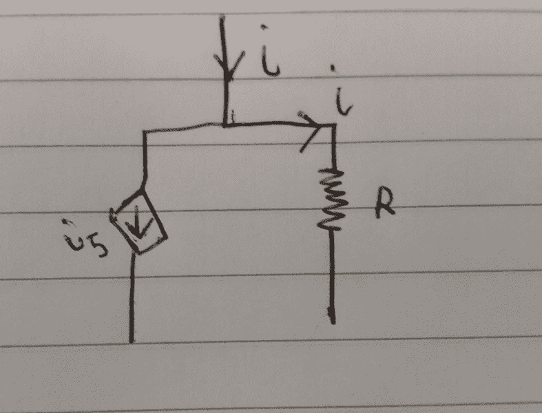

Say I have the following hypotehtical circuit,
Handwritten circuit schematic: current i enters a node from above and splits, with an arrow labelled i flowing right to a resistor R, and a dependent current source labelled i5 with a downward arrow on the left branch, which ends open at the bottom.
Ignore the open circuit at the bottom.
Would I be correct in saying that all of the input current i goes to the resistor R or would it be split? Because I know for a current source that it has to produce that current i5 no matter what.
  • Handwritten circuit schematic: current i enters a node from above and splits, with an arrow labelled i flowing right to a resistor R, and a dependent current source labelled i5 with a downward arrow on the left branch, which ends open at the bottom.
What circuit law could you appeal to in order to find out?
KCL?
i = i1 + i5
where i1 is the current through resistor.
Well that answered my question.

gneill said:
:smile:
Thank you. Apologies for the stupid question. I forgot the basics.
No worries. You got the answer by your own efforts with just one vagueish hint, so that's a win!

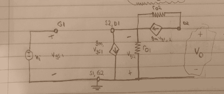

Sorry. I'm just having some second doubts in relation to a different question but on the same topic.
Hand-drawn small-signal circuit with input source vi, dependent current source gm vgs1, resistor ro1, dependent current source gm vgs2 and resistor ro2, nodes labelled S2, D1, D2, S1, G2 and output voltage vo.
For this circuit, I was told that ALL the current $$g_mv_{gs,2}$$ flows through resistor $$r_{o2}$$. Now that doesn't make sense if I apply KCL at the the middle node on the right side(S2, D1).
KCL at S2, D1 $$ g_mv_{gs,2} + i_{r_{o1}}= i_{r_{o2}} + g_mv_{gs,1}$$
Rearranging,
$$ g_mv_{gs,2} = i_{r_{o2}} + g_mv_{gs,1} - i_{r_{o1}}$$
That is telling me that in fact, not all of the current is going through r_o2. See the related thread,
https://www.physicsforums.com/threads/cascode-amplifier-small-signal-model.940510/#post-5951679
It made sense at the time, but I am having doubts about it now.

The current generator must "draw in" the same current that it "pushes out", and the only path for that drwin-in current is via that resistor.
Rearranging,
And if ##i_{r_{o2}} = g_mv_{gs,2}##, what does the equation tell you?
  • Hand-drawn small-signal circuit: a resistor labeled ro2 on top wire, a dependent current source gm vgs,2 in the middle branch, with blue arrows showing current direction, and a node labeled D2 on the right.
View attachment 221998And if ##i_{r_{o2}} = g_mv_{gs,2}##, what does the equation tell you?
Ah.. I get it now. So the current source is fixing the current in that branch no matter what and if other currents were to flow into ro2 then, that fixed branch current wouldn't be fixed anymore.
