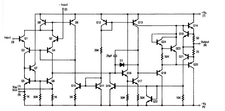

No. Real world amplifiers have finite gain. That gain can be very high for optimized multi-stage amplifiers like you see in opamps, but it is still finite.
Here is an introduction to finite open loop gain: https://en.wikipedia.org/wiki/Open-loop_gain
And are you familiar with the transistor circuitry inside a typical opamp? That is the easiest way to see why the gain of real-world amplifier circuits is finite (and never infinite). The LM741, for example is one of the earliest opamps, and one of the easiest to understand, IMO. Here is a link to a good introduction, as well as the internal circuit of the LM741. Can you say a bit about what each stage of the opamp is doing, and what the gain of each stage is? And if you are familiar with the differences between Bipolar and CMOS Current Mirrors, can you say a bit about why higher-open-loop-gain opamps are often based on CMOS circuitry? :smile:
http://www.righto.com/2015/10/inside-ubiquitous-741-op-amp-circuits.html

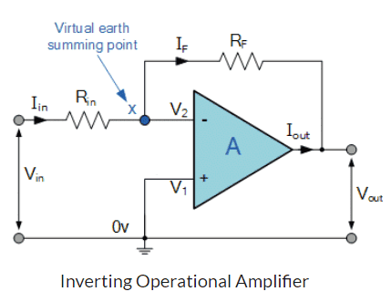

YES It does try to keep both inputs the same, but NO that is not zero or ground.
Before anyone complains, not exactly the same because there may be an input offset voltage - in the 741 as much as 6 mV, though modern chips can be hundreds of times lower, MAX400 says 10 μV.
But your big problem is understanding the external circuit. An inverting amp can connect it's + input to ground/ Earth / zero and the - input will be maintained the same (or very close, as above) which is called a virtual earth. Then the input is applied to the - input via a resistor which is part of the gain-setting fb cct.
EDIT: I missed one point. The output can be zero when both inputs are the same, even if that is both at 5V say. The output depends on the difference between the inputs. So though the effect of the external circuit is to minimise this difference, there must actually be a small difference for the output to be non-zero.
PS
Berkeman takes me back to 1973 in Dudley reference library poring over a 741 datasheet trying to figure out what on Earth an op-amp was and why, if it had a gain of 100,000, did we HAVE TO apply so much negative fb and end up with single figure gain.
I like your reference.
Seeing your 741 post, I picked up my NS Linear Databook (1980) (still on my bookshelf! Why?) and it had two bookmarks (punch cards). The first was the 741, the second just over half an inch further on, was ?

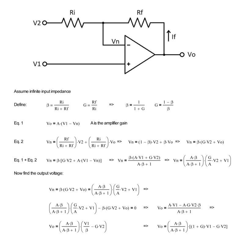

Kaguro said:
Summary:: I think negative feedback should converge the inputs exactly same.
If this happens, and it happens quickly, how does an op-amp amplify any signal at all?
It 'amplifies' the signal by chasing a potted down version of the output and applying it to the inverting input. The difference between the two op amp inputs will with be a tiny bit positive or a tiny bit negative (a sort of quasi-zero) which is just enough to raise or lower the output signal level to what it should be (= an amplified version of the input signal).
It's strange how everyone can appreciate how a thermostat works; there's something intuitive about the effect of a delay and a bit of hysteresis in that non linear (on/off) feedback system. If you just imagine a bimetal strip with a proportional output, you have the same situation as in an op amp.
While I'm a big fan of intuitive understanding, sometimes, for simple circuits, that is easiest to achieve after some analysis. This is a case where the answer is in the equations, and that analysis is pretty straight forward algebra. Although I will admit it's easier if you start out knowing what form the answer will be in.
The bottom line of the above bit of Maths is that when A approaches infinity (like the Op Amps you can buy today) and when the result ends up as
VO = V1(1-G) -V2G
and, when G is a lot bigger than1, you get
VO =(V2-V1)G
which is determined only by the values of the two resistors.
You mean VO = V1(1+G) -V2G and VO = (V1-V2)G
Anyway, this is an exact solution for this problem, you can use it as you wish. It is the basis for all Op-Amp negative feedback circuits.
Normally if you want a differential amp VO = (V1-V2)G, you would add a resistive divider in front of the + input to reduce that gain by G/(G+1). This turns out to be the same two resistor values used in the - side (actually, just the same ratio; just like a wheatstone bridge).
But there are other Diff Amp implementations too, typically with inverters and summers. For example, you may want the same input impedance in each input (an "Instrumentation Amp"). The simple circuit shown doesn't do that.
Whoops - wrong sign in my workings! Thanks
Yes, the ideal Op-Amp solution would have A →∞
From Dave's post,
##V_n = \left( \frac {A.\beta}{A.\beta +1}\right) \left( \frac G A . V_2 +V_1 \right) ##
which when A→∞ becomes ## V_n → 1 \left( 0 . V_2 +V_1 \right) \ \ ## or ##\ \ V_n → V_1 ##
Isn't that exactly what Kaguro said right at the beginning?
