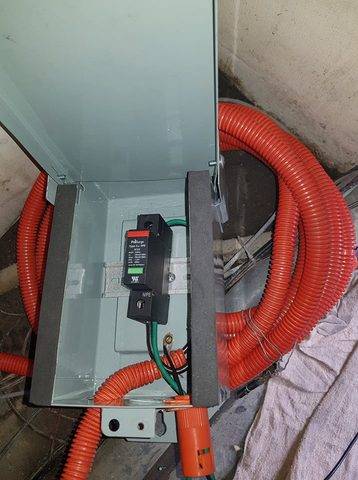

The building service entrance is 3 phase with delta transformer... per phase is 120 volts.. but we never have any 120 volts outlets because 100% of our equipments are all 220 volts.. therefore my 220 volts in the outlets came from the line 1 and line 2 (or line 2 and 3 or 1 and 3) of the 3 phase.. in another floor.. the breaker is 3 phase. The one in the picture is admin breaker supplying only lights, cctv and security, hence only single phase needed and the design just tapped the phase 1 and 2 of the 3 phase service entrance power. With all these information.. my Spd type 2 that is line to ground won't be engaged at all because I don't have any equipments in the outlets that is 110 volts, right? If you agree, then I'll remove the existing SPDs and return them to supplier and buy a line to line SPD or delta SPD instead. Thanks.
Here's the breakers in my service entrance:
Photo of a service entrance panel interior with three rows of breakers: a three-pole 100 A breaker on the left, a two-pole breaker in the centre, and a three-pole breaker on the right, with red, black and blue cables and a terminal block below.
The front silver thing is the ground lugs. We don't have any neutral. If you will measure the voltage in any of the lines to the ground or even the enclosure, it's 120 volts.. but we never use 120 volts because all our equipments are 240 volts.. the one in the middle is the admin which connects to the panel you saw earlier. Therefore what I need are line to line SPD protecting 2 phases and not 1 phase to ground which is not utilized, right?? In the event there is surge in the line to line (phase 1 to phase 2), would it separately shunt to ground without any equipments actually connected to any phase and ground (or 110 volts we never used?)
  • Photo of a service entrance panel interior with three rows of breakers: a three-pole 100 A breaker on the left, a two-pole breaker in the centre, and a three-pole breaker on the right, with red, black and blue cables and a terminal block below.
OK, your last post added much missing information and cleared up much confusion. (Whew!)
I see two relatively easy approaches:
  1. Use a Control Transformer to feed the power supply, 240V primary, 120V secondary
  2. If it is legal with your particular wiring where you are, tap 120V from one leg and use the common Ground as Neutral.
Either way, you can then use a 120V SPD at the power supply. This addresses your concern about the 300V input limit of the power supply.
With option 1., if you use an appropriately sized (small enough) Control Transformer you can use a type 3 SPD and you do not need the 10m wire length before the SPD, the transformer impedance will be more than adequate. You will still need a Ground connection wire for the SPD (or use the conduit if it's legal there). That's because high voltage spikes can get thru a transformer due to the capacitance between primary and secondary.
If you use option 2. above, you will need a type 2 SPD.
You could ask your power company or the city electrical inspector about the legality of option 2.
Cheers,
Tom
p.s. Please let us know how this all works out. Many people here have put time and effort into this and we are always curious.

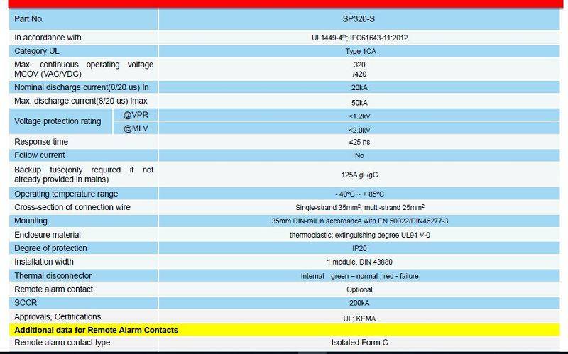

In your post. You were assuming we have 120 volts equipments or power supplies. We never have this. If we order items from the US which uses 120 volts. We always use up-transformer to convert the 120 volts to 240 volts because all our gadgets and stuff uses 240 volts.. therefore what would be the use of 120 volts.
But I realized you were right that in my current installation, the 320 Vac SPD is too much for the 120 volts phase to ground that we never use or a mismatched.

Lastly. I found out I can no longer return the 320Vac type 2 SPD. If I'd use this for the above idea of using 120 volts from line to ground.. I wonder if there is some adverse behavior from using SPD of much higher voltage rating (320 Vac) for power source that is much lower (120 volts)? I can't find any answer of this online because no many are foolish to use much higher SPD voltage rating but I'm stuck with it so asking this.
The 'adverse behavior' is the higher clamping voltage, which you cited as a problem earlier.

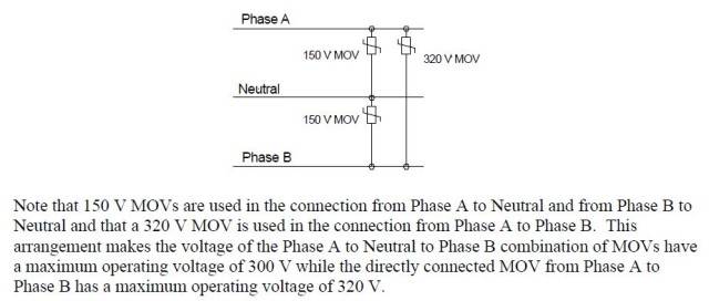

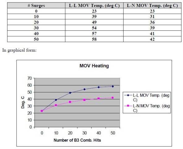

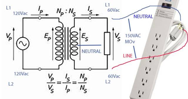

Here's an interesting experiment in the paper at http://www.surgesuppression.com/ima...licationofSurgeSuppressionRevDate10202005.pdf
Wiring diagram of surge protector MOVs between Phase A, Neutral and Phase B: 150 V MOVs from Phase A to Neutral and from Phase B to Neutral, and a 320 V MOV directly from Phase A to Phase B.
Table of MOV temperatures in deg C by number of surges, with L-L and L-N columns, followed by a line graph titled MOV Heating plotting both temperatures against number of B3 comb. hits.
Power was applied to Phase A and B and thermometer was used to measure the temperature of the MOV when surge was introduced (details in the paper above).
Based on the much higher temperature rise in the discrete line-to-line MOV, the discrete line-to-line MOV absorbs a much larger portion of the surge current and energy than the combination of the two line-to-neutral paths.
In the experiment, why did the MOVs heat up in the 2 element Phase A to ground & Phase B to ground MOVs (instead of just the 1 discrete line to line MOV).. is the current of the 2 element series not shunted to neutral? I assume neutral is same as ground.
If the neutral were made ground.. would the results be the same?
And lastly if there was no discrete line to line MOV used.. what would be the behavior of the 2 elements MOV in series (the Phase A to ground and Phase B to ground MOV).. would it behave less than discrete line to line or similar in shunting the current? What do you think?
Knowing the answers above would wrap up my questions about SPD and end up this thread once and for all. Lol.
  • Wiring diagram of surge protector MOVs between Phase A, Neutral and Phase B: 150 V MOVs from Phase A to Neutral and from Phase B to Neutral, and a 320 V MOV directly from Phase A to Phase B.
  • Table of MOV temperatures in deg C by number of surges, with L-L and L-N columns, followed by a line graph titled MOV Heating plotting both temperatures against number of B3 comb. hits.
kiki_danc said:
kiki_danc said:
View attachment 231383Power was applied to Phase A and B and thermometer was used to measure the temperature of the MOV when surge was introduced (details in the paper above).

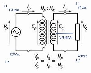

Circuit schematic of a delta-connected transformer winding with terminals a, b and c; labels read 120 Vac on the a to b line, 120 Vac on the c line and 120 Vac on the bottom line, with a single 320Vac MCOV varistor drawn between terminal a and terminal b.
Of course I won't try it (I'm not crazy to experiment). Just want to know what theoretically would happen.. would it explode? Or work in a while then shuts down? etc.
  • Circuit schematic of a delta-connected transformer winding with terminals a, b and c; labels read 120 Vac on the a to b line, 120 Vac on the c line and 120 Vac on the bottom line, with a single 320Vac MCOV varistor drawn between terminal a and terminal b.

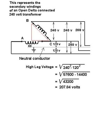

This is in response to your post #72. I must have forgotten to click the POST REPLY button before I went off-line for a while.
Circuit schematic of a delta-connected three-winding transformer with terminals a, b and c; labels read 120 Vac across the lines, and two 320Vac MCOV surge varistors are wired between lines a and b with a ground symbol between them.
Another case of insufficient information or under specified condition. You show a 3-phase transformer without a Ground or Common connection, in an earlier post you specified 3-phase 240V with 120V to a Common. Here the 3 lines are labeled 120Vac but your earlier posts stated the transformer windings as 240V. When measuring 120Vac on this diagram where is the other voltmeter lead placed?
  • Circuit schematic of a delta-connected three-winding transformer with terminals a, b and c; labels read 120 Vac across the lines, and two 320Vac MCOV surge varistors are wired between lines a and b with a ground symbol between them.
The other voltmeter lead is placed in the ground lugs of the panel which is simply connected to the Earth or soil. Our power company doesn't have separate ground or neutral. My service entrance has only 3 wires (3 phase) coming to the building.. we provide our own ground by sticking it to earth. I'm sure of this because I inquired from the power company years ago.
Anyway, the 120 volt thing has opened the floodgates in that I can now access all of amazon products which are based on 120 volts. Before I had difficulty finding supplier.. and only found one prosurge distributor locally. Now I can buy for example $69 Prosurge at amazon like https://www.amazon.com/dp/B012IR9Q2K/?tag=pfamazon01-20

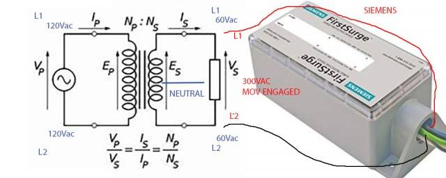

Siemens TPS3A03050 120/240 Type 1 Split Phase Surge Protective Device Lightning Arrester Replacement
In the US. Is there a 120/240 split phase power system? Is it the same as the Delta with 120 volts per phase in my place (and 240 volts line to line)?
I promise this is the last level of inquiry as I don't want to get so much of your time. And as a way of saying thanks.. I can give you my 240 volts prosurge if you need it.. lol

Table of MOV temperatures in deg C versus number of surges: L-L MOV rises from 23 to 58 and L-N MOV from 23 to 42 over 0 to 50 surges. Below it, a line graph titled MOV Heating plots both series against Number of B3 Comb. Hits.
Remember that the MOV's act like a resistor when they conduct, their voltages rise as their current increases. The 300V sum of the 2 MOV voltages is close to the 320V of the line-to-line MOV. With the voltages being so close they are sharing the current.
The current DIFFERENCE between the 2 elements would typically be shunted to Neutral (which is usually Ground). For instance if one of the MOV's conducted 100A and the other 120A, then 20A would typically flow thru the Neutral lead. There is not enough detail of the test setup nor is it known to me if your Neutral/Common is indeed connected to Ground, and if so what the current capability is of that connection.
similar, see previous comment.
similar... but then you have the situation of when one fails you have no protection on that line.

So if i buy the siemens 120/240 split phase spd with discrete line to line protection. It should be compatible to my delta 3 phase with 120v each phase?
Reference your post #73.
View attachment 231389Remember that the MOV's act like a resistor when they conduct, their voltages rise as their current increases. The 300V sum of the 2 MOV voltages is close to the 320V of the line-to-line MOV. With the voltages being so close they are sharing the current.The current DIFFERENCE between the 2 elements would typically be shunted to Neutral (which is usually Ground). For instance if one of the MOV's conducted 100A and the other 120A, then 20A would typically flow thru the Neutral lead. There is not enough detail of the test setup nor is it known to me if your Neutral/Common is indeed connected to Ground, and if so what the current capability is of that connection.
In normal power system like in US single phase supply.. when the SPD short circuits to ground.. I thought all the current would go to ground.. isn't it this is the purpose of SPD being connected to ground... where all current would go. In the above experiment, let's say the neutral is connected to ground and have enough wire size.. isn't it the 100A conducted in one would go to the ground? Why did you say only 20A goes to the ground? Also the 2 phase is 120 degree out of phase like in the following:
Graph of three-phase power voltage against time, showing three sine waves labelled Phase 1, Phase 2 and Phase 3 with a Common line at zero, y-axis from -240 to 240, with 1/180 second and 1/60 second marked on the time axis.
so when one is conducting.. the other may not.. or you mean they conduct at same time? But why the 20A difference?
similar, see previous comment.similar... but then you have the situation of when one fails you have no protection on that line.

The experiment seems to be saying that discrete line to line SPD protection is more effective.. why do you say it's the same? The paper comments on the paragraph about it that:
"In contrast, if an SPD with only seven modes of protection is utilized for the same system and the line-to-line protection mode is proteced by the series combination of the line-to-neutral and neutral-to-line modes or the line-to-ground and ground-to-line modes, then those modes (line-to-neutral or line-to-ground) are intentionally exposed to unnecessary and undesired transient voltages. In essence, the SPD is sharing the line-to-line transient with the line-to-neutral and line-to-ground modes and creating voltages on those modes that would not be present with the use of a discrete all mode protection SPD."

Tom. Thanks to you the supplier and distributor have decided to send me a 150Vac SPD for free (after they realized we are right the clamping voltage can increase).. but then I'm having second thought.. I plan to get the Siemens 120/240V split phase at amazon with protection mode that includes L-L. As detailed in my last message, Protection mode that include L-L is more superior than the series connections of two spds, right?

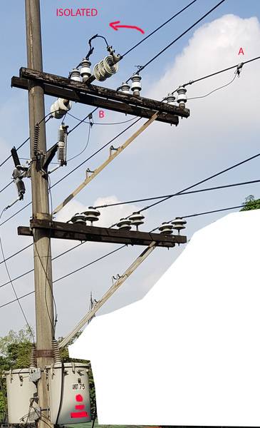

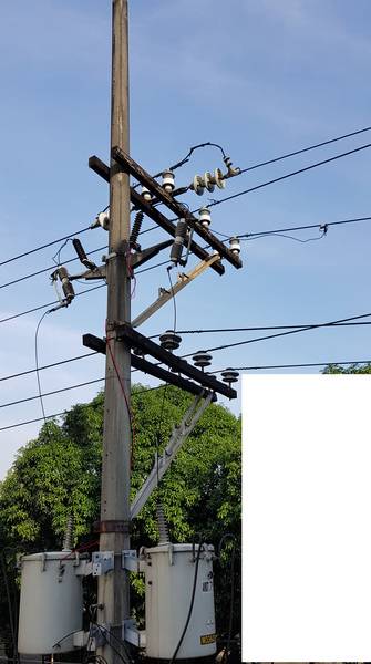

And before I order. I'm verifying if my transformers are really Delta or Wye. Looking at file photos. I found out there was a neutral or ground entering the busbar (white wire among the 3 big black).
This is my actual transformers (some details faded for security).
Photo of a utility pole with two pole-mounted transformers, labeled A, B and C, with black high-voltage wires and a partly obscured label reading AVOT 75.
The two transformers tap to only 2 high tension wires above it, the 3 phase wire entering my service entrance is from the A, B and C terminals. The right transformers has label "x1", "x2", and "x3". So it comes from "x1" and "x3" while on the other side, the terminal C is from "x1".
Do you recognize the transformers as Wye or Delta?
And if I order the Siemens 120/240v split phase at amazon.. it should be compatible by only tapping to the 2 phase of the 3 right? (since I'd just use the admin breaker for the surge protectors and not the full 3 phase breakers).
https://www.amazon.com/Siemens-TPS3A03050-Protective-Lightning-Replacement/dp/B0052NKYC4/ref=sr_1_1?ie=UTF8&qid=1538355017&sr=8-1&keywords=siemens+120/240v+split+phase
Hope to order it soon and done with all this so we can focus back on string theory... lol.. my electrician will install the Siemens don't worry. Thank you.
Right.
With only 2 high tension wires and 2 transformers I fail to see how there can be 3 phases. At a minimum you need a wire and transformer for each phase. Can you supply a sketch of the the wiring for both the primary and secondary of the transformers? For instance there has to be at least 2 terminals wired for both the primary and secondary of each transformer.

Tom.G said:
Right.
Yes, it looks like the busbar box in the photo already has 120V going thru it. That's the Blk, Wht, Grn trio in the lower right. Wht = Neutral, Blk = Hot, Grn = Earth Ground. Why are you resisting using the existing 120V for the 24VDC power supply? Or even a control transformer to step the 240V down to 120V? After all, the time spent so far already exceeds the cost of a control transformer by a big margin.

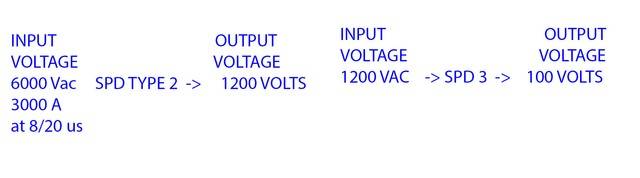

My solution is to add a type 3 to the equipments so the 1200 volts or so VPR in the type 1 or 2 would be lowered to 220 volts. This is better solution because remember I have 6 meters wire connecting from type 1 or 2 to equipments.. those can increase the voltage beyond 300 volts..
I'll find the explanation of how they can make 3 phase from 2 wires from high tension wires and 2 transformers and post it later.

I'm sure it's 3 phase from 2 transformers. I used binocular to look at the wires. The wires are tangled so I can't tell the details. But the following is one explanation of how to get 3 phase from 2 transformers.
http://forums.mikeholt.com/showthread.php?t=144067 (better source.. )
https://www.diy-forums.com/threads/three-phase-from-2-transformers.279495/
kiki_danc said:
I'm sure it's 3 phase from 2 transformers. I used binocular to look at the wires. The wires are tangled so I can't tell the details. But the following is one explanation of how to get 3 phase from 2 transformers. https://www.diy-forums.com/threads/three-phase-from-2-transformers.279495/
If you will google "3 phase from 2 transformers".. many explanations would come out.. for example:
Diagram of the secondary windings of an open delta connected 240 volt transformer, with a neutral conductor, voltage labels 240 v, 240 v, 208 v, 120 v and 120 v, and a high leg voltage calculation giving 207.84 volts.
best explanation in the following from above.. "It's called "open delta". If you Google this term, you will get all kinds of info.
"Picture three transformers providing 240/120V 3� 4W service that you mention. Now remove one not center-tapped. The voltage and phase across the terminals where the removed transformer was formerly connected is still the same.
BTW, POCO's still do this. "
here it says "open delta".. so I guess it answered what kind of transformers I have.. an open delta.. btw.. are you an electrical engineer?

Yes, I looked at the link you first posted and the links in it. They are all talking about using 2 transformers fed from a 3 phase generator and 3 phase distribution system. That's 3 phases with a 120° phase shift between them on three wires. You stated there are 2 wires in the high tension distribution side, not 3. Even the wikipedia diagram about half way down the page shows a 3 phase supply. How can you receive three different phases on 2 wires? There is only on way to connect a meter or transformer to them

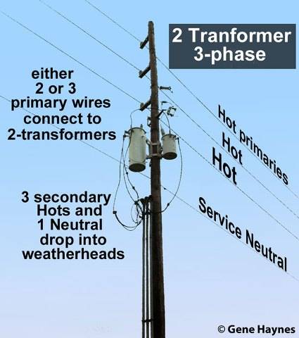

There are 3 high tension wires above it.. but there is only one terminal per transformer.. I can't see where the third one taps to... where should it be theoretically? Maybe you can find the third wire?
Utility pole carrying crossarms with insulators and several overhead high-tension wires, with two pole-mounted transformers below the crossarms against a backdrop of green trees and blue sky.
  • Utility pole carrying crossarms with insulators and several overhead high-tension wires, with two pole-mounted transformers below the crossarms against a backdrop of green trees and blue sky.
I think I found the third wire.. it's tapped to small terminal (shown in red lines) at left transformer (connecting to the front most high tension wire)… the 2nd is hidden.. the rear high tension wire is connected to the terminal at right transformer
Utility pole with crossarms and insulators carrying several high-tension wires, with two pole-mounted transformers at the base and a red wire running down the pole to one transformer.
Whatever. It's an Open Delta Transformer.. so the Siemens 120/240V split phase is compatible by connecting to the 2 phases of 3? If yes. I'll order at amazon now and be done with all of this :)
  • Utility pole with crossarms and insulators carrying several high-tension wires, with two pole-mounted transformers at the base and a red wire running down the pole to one transformer.
reviewing my electrical plans.. my wires in admin breaker is 8mm^2 and ground is just 3.5mm^2 to main circuit breaker... so I can't use line to ground because the ground wire size is made smaller because we always use line to line in my place. Anyway in the US.. when you connect line to neutral and get 120 volts.. and you touch the neutral wires in other places in the building or room. won't you get electrocuted? So I'm thinking if I really connect line to ground.. and touch other ground wires.. I may get electrical shock? no?
Whatever, the siemens 120/240V split phase is good to go.. isn't it.. when it's written protection mode includes L-L.. I assume it uses discrete MOV that heats up instead of moving the current to ground.. (?)
Yes, the Red looks to be the long-lost third wire. And the diagram in post #85 is similar to what I suspected when you said only 2 wires, I just wasn't familiar with the Open Delta configuration. (I learned something new. GREAT!)
