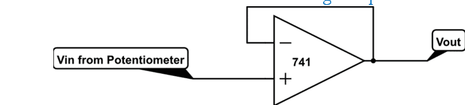

Find out the input impedance in a LM741 Op-Amp with open loop gain around 10E+6, and with non-inverting terminal receiving variable voltage and inverting terminal connected to output (Negative feedback)
##V_{out} = A_{v} (V_{+}-V_{-})##
In this case, there is negative feedback. ##V_{out}## is almost equal to ##V_{in}## in this case. But I really can't understand how to even proceed to find out the input impedance in this case, from the equation I know. Can someone help me out in figuring how should I proceed?
How about the defnition of input impedance ?

The datasheet does show me that the input impedance of the LM741 IC is around ##1M \Omega##. But, in the case of negative feedback in this case, I have read that the output impedance decreases, and thus the input impedance increases. I want to find a way in order to correlate the new input impedance to the original input impedance of LM741. That's exactly where I need help.
berkeman said:
Maybe I'm missing something, but they are asking for the input impedance of the LM741 opamp in the follower circuit. There is *nothing* else connected to that + input pin...
Yes, but there is a negative feedback in this case. I had read that the input impedance increases in the case of negative feedback. Isn't it possible in this case to correlate the increased input impedance with the original impedance of LM741 IC?
In all but the most complex models of this device, the feedback does not affect the NI input. The differential input stage will do a very good job of isolating the two inputs. Even at the transistor level the effect isn't significant.

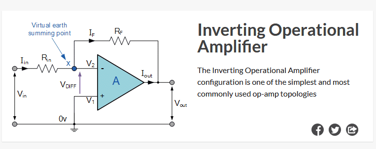

https://www.electronics-tutorials.ws/opamp/opamp_2.html

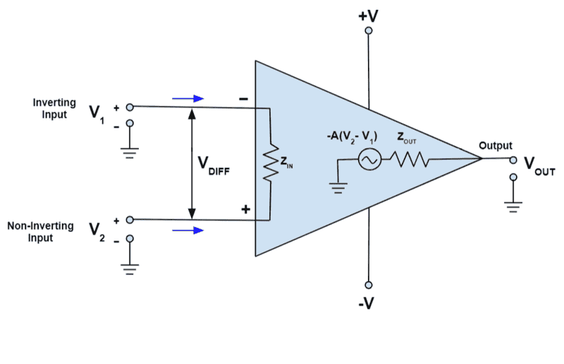

That triangle everyone draws for amplifiers requires some assumptions among the people discussing the circuit. It's better suited for schematics than analysis. If you replace it with a more explicit circuit model, like the one below, it will make the algebraic analysis easy (easier). Of course, there are many possible models, depending on what circuit behaviors you care about. You may add additional complexity, like frequency dependence, to some parameters, or you may choose to set some values to 0 or ∞, if those are good approximations for you're application.

Sorry - but I cannot agree. Both transistors in a differential amp (long-tailed pair) share a common node (both emitter terminals are connected). Therefore, the input resistance of T1 depends, of course, on the signal that exists at the input of T2.
As a consequence, we have different input resistances for the 3 most popular operational modes:
* unsymmetrical (one base grounded)
* differential-symmetrical (Vin1=-Vin2)
* common mode (Vin1=Vin2)

For operational amplifiers with limited high gain and infinite input impedance, the following will occur.
If it is used in a non-inverting amplifier configuration, the negative feedback does not affect its input impedance, because a finite number multiplied by infinity is still equal to infinity. Even if the input resistance of Lm741 is only about 1Meg Ohm AC resistance, it may be sufficient for most applications, so there may be no special benefit to further increase it.
On the other hand, if it is used in an inverting amplifier configuration, even if the internal resistance of the operational amplifier is infinite, after adding negative feedback, the input impedance will immediately become equal to the resistance of the external input series resistor, but this resistance cannot be too large, so the input impedance will become relatively low, which may be worrying engineers.

One further comment: In your case (unity gain amp, 100% feedback) the resulting input impedance at the non-inverting input could be - mathematically correct - calculated. Howver, the result would have no practical meaning. Why not?
Assuming rin=1MΩ (without feedback) and Aol=100dB (identical to the loop gain) the formal calculation for the input resistance with feedback would give rin=1E6*1E5=1E11 Ohms (100 GΩ).
Such a value has no practical meaning because all the neglected parasitics (leakage and capacitive effects) would dominate.
