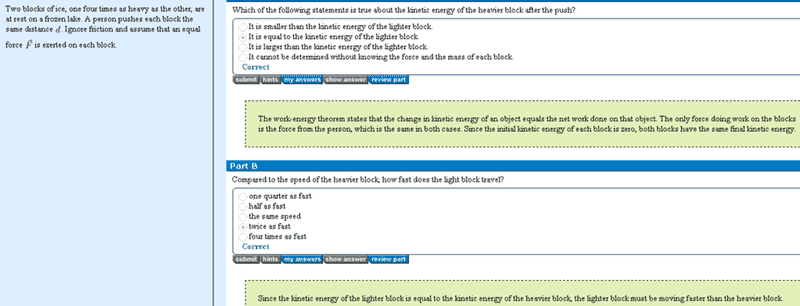

Hi everyone! So I am taking mechanical physics right now (calc based) and I seem to have a bit of trouble understanding work / kinetic energy.
Two multiple-choice homework questions with feedback: the first asks how the kinetic energy of the heavier block compares to the lighter one after the push, and the second asks how fast the light block moves compared to the heavy block.
[tex]\vec{F}[/tex]=m[tex]\vec{a}[/tex]
Kinetic energy= [tex]\frac{mv^{2}}{2}[/tex]
Work[tex]_{net}[/tex] = [tex]\Delta[/tex] [tex]\frac{mv^{2}}{2}[/tex]
Okay so first, my understanding is like this, please correct me if I am thinking about it the wrong way. [tex]\vec{F}[/tex]=m[tex]\vec{a}[/tex] so if the same amount of force is applied to both and one has a different mass from the other, than acceleration is different and thus velocity is different.
With that said I knew that velocity is different, but why should the kinetic energy be equal?
Can't we have a situation where the velocity is changed to the point where if we plug our two velocities and our different masses in the [tex]\frac{mv^{2}}{2}[/tex] equation the kinetic energy will not be equal?
Now here is where I get lost, my thinking was when there is friction. In the problem it says no friction. If no friction shouldn't the velocity be the same for both masses when the same force is applied? because there is no fiction force to oppose it?
So I am kinda lost as how to understand the way kinetic energy work.
Thanks for your time.
[tex]Fd=W=\frac{1}{2}mv^2=KE[/tex]
If the same amount of force is needed to push two objects of different masses an equal distance, then both objects will have equal kinetic energies, albeit different velocities for the two objects if the kinetic energies between the two objects are to be the same.
So work = kinetic energy?
Ah, that makes a little more sense
i was thinking kinetic energy is the change in work
Whoops, my mistake. It is. However, your initial is 0 and your final is equal to (1/2)mv^2.
