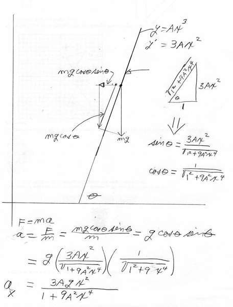

How about a numerical solution? In my attachment, I have (I think) calculated the horizontal acceleration to be..
a = (3Agx^2)/(1+9A^2x^4)
This seems reasonable to me since the horizontal acceleration, to the left or -x direction should be zero when x = inf, and zero when x = 0. So, from a starting point, say (1,1) assuming y = x^3 can we find the time until the acceleration = zero? I haven't done this as yet but it might work.

In post #19, Arkavo suggested that we use an analogy of a small ball rolling down a slope y = |x^3|.
Let's say we start at x = 1, y = 1. Can the above analysis determine the time for the ball to roll to the bottom of the curve. This should be 1/2 the period of oscillation. Conservation of energy should show that the velocity of the ball at the bottom is 4.429 m/sec.

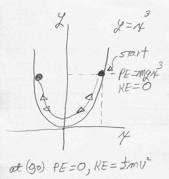

This is why I am asking the question. If we assume a ramp y = x^3, the potential energy vs height is the same as in the given problem.since there is no friction, one can determine the velocity at the bottom of the curve at (0,0). The analogy seems good to me. I did a numerical solution as to the time for a mass to start at 1,1 and reach 0,0. I wonder if it is the same as has been calculated above. As a math and science tutor,. I always tell my students to check their work in some manner, like approaching the problem from a different angle. This is what I am looking for here.
  • #35
Oh. BTW, the acceleration function you mention above is almost the same as the one I derived in post #14. Itried a numerical approach then and did not get the correct velocity at the bottom of the curve. In my original post, I only considered the acceleration in the x direction.
  • #36
Oops, the acceleration function in 33 is the same as I derived if A = 1, in the Ax direction anyway.

The motion of a massive point constrained to move one the curve ## y = x^3 ## is not similar in any way to this problem. Its potential energy has no minimum, so there is no oscillatory mode.
The analogy with ## y = |x|^3 ## is even worse, because the velocity vector is not continuous at ## x = 0 ##.
  • #38
Hmmm,.. I must disagree. Look at my attachment. A ball in a trough will oscillate between say (1,1) and (-1,1) passing through (0,0). At (0,0) there is no PE, only KE. At the start, there is no KE, but there is PE = mgx^3. The ball will obviously oscillate. My question is, what is the period of oscillation or the time from (1,1) to 0,0)

You must not disagree. You must get your things straight. ## y = x^3 ## does not look like your trough at all.

Rude, would you agree or disagree that a ball on a ramp y = |x^3| would apply to this case?
Assuming you agree., then in your equation above, what is m. If it is mass, does it matter
For the case where y = |x^3| if we start with a particle at x = 1, then y = 1. K = 1 . It seems your equation reduces to T = 2 * 1.402. Am I interpreting this correctly?
See my previous post # 45. I see nothing wrong with your analogy except that it didn't help to get the answer.
You can't use k=1, why do you? And yes, m matters. My equation does not reduce to what you say - how did you arrive at that conclusion?
The basis for this entire effort is the conservation of energy: mv^2/2 + kx^3 = kA^3 for 0 <= x <= A. The transit time from A to 0 is T/4.
I don't see why it doesn't apply to your curve, but ultimately the integral ∫dζ/(1 + ζ^3)1/2 has to be evaluated from 0 to 1. ehild used wolfram alpha and darkxponent cleverly recognized the applicability of the beta function to this definite integral. They both got to the answer I posted in post 43.

rude, let's reset a bit. here are to many Ks, ks, As T and etc to keep track of so let's start with as simple case as I can think of namely y = |x^3| and work with this.
I have always learned that conservation of energy means:
Potential energy at the start = kinetic energy at the bottom (neglecting relativistic issues :-) )
this means (1/2)mv^2 = mgh where m = mass, v = speed (not necessarily velocity a vector), g = 9.81 and h = heighth. Using this equation, the velocity at the bottom or anywhere else in the trajectory does not depend on the mass.
Surely, we can agree that a ball (assuming no rotational issues) takes a time to travel from (1,1) to (0,0).
All I am asking is what do you think the time is? in seconds. Is it 1.42 seconds? or what.
