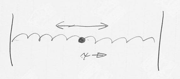

  • #59
Here is the OP.
The potential energy of a particle varies as U=K|X|3, it is oscillating and the amplitude is 'A' then find out the time period's variance with 'A'
Please tell me where m fits in? You might think that since "potential energy" is mentioned that mass has to be a factor. However,
The question is how the time varies with the amplitude. Recall that for a pendulum, the period is
2(pi)sqrt(L/g) the mass does not matter. Sure you can talk about the potential energy of the ball at various heights but as far a the period is concerned, mass does not matter and should not be in the final answer.
Guys, picture a physical situation. A ball in a salad bowl. You let it go at the rim and it will oscillate back and forth forever if there was no friction. This is the same thing except the side of the bowl is defined as y = K|x^3|.
It could be defined as y = K|x^10| just as well. Clearly, the problem has a solution. I can build this bowl and measure the time with a stopwatch.

For any system where kinetic energy is ## T = \frac {mv^2}{2} ## and potential energy is some ## \Pi(x) ##, so that ## \Pi(0) ## is a local minimum, there is an oscillatory mode in certain region close to ## x = 0 ##, and, if ## \Pi(x) ## even, there is some ## A ## the amplitude.
For such systems, the equation of motion is $$ v = \sqrt { \frac 2 m (\Pi(A) - \Pi(x)) } $$
If ## v = \dot{x} \sqrt {1 + 9x^4} ## and ## \Pi(x) = mg|x|^3 ##, the equation is $$ \dot{x} \sqrt {1 + 9x^4} = \sqrt { 2g (A^3 - |x|^3) } $$ or $$ \dot{x} \sqrt { \frac {1 + 9x^4} { 2g (A^3 - |x|^3) } } = 1 $$ yielding $$ \int_0^A \sqrt { \frac {1 + 9x^4} { 2g (A^3 - |x|^3) } } dx = \int_0^{T/4} dt = \frac T 4 $$

@barryj: I would agree with Voko here. This is not an analogy.
voko said:
Except that 'v' here is not just the time-derivative of x it was previously.
I think this is the reason why this won't work. The motion is in two dimensions and the given problem is just in one dimension.

The only common thing which you are talking about is the potential energy function is NOT common.
Let 'd' be the distance traveled by the ball.
1-Looking at the given question potential energy is given by U = K*d^3.
2-Potential energy for y = x^3, comes out to be, U = mg*x^3,
where d^2 = x^2 + (kx^3)^2
and d NOT equal to x.
So the analogy won't be for the curve y = kx^3 ,
but i think the analogy would exist for y^2 = (x^2+y^2)^3
as this would give U = mg*d^3, same as that given in question.
  • #73

Well, I got the answer I wanted even though it might have been for the wrong problem. I keep thinking about how the OP could be implemented and I think a non-linear spring might be an example.Thoughts?
