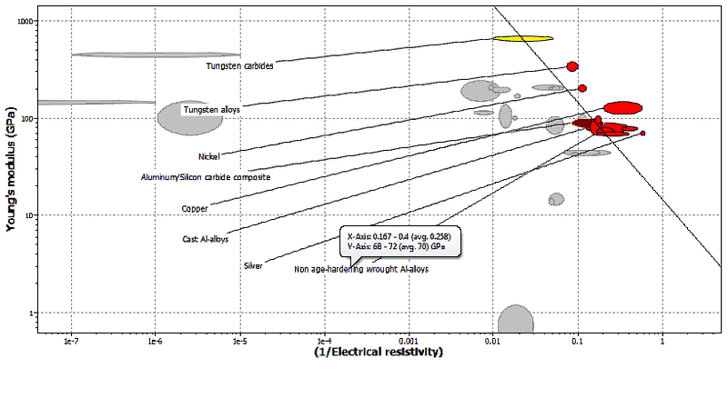

In a sense, yeah, you are kind of free to move that line around depending on what you are trying to do. At this stage in the game you aren't trying to select THE material, but rather a family or families of materials. Ill try to show you with an example from a project I was working on. I was in charge of selecting materials suitable for a high-voltage power line. I broke it up into 2 section: a tensile load section, and an electrically conductive section. For the conductive section I derived a material index M = ρe E, where ρe is the resistivity and E is Young's modulus. I wanted conductivity, however, its not available to plot in CES so I plotted the reciprocal of resistivity which is conductivity. Now I wanted to maximize conductivity(minimize resistivity) so I placed a line with a slope of negative 1, as per the log form of my material index suggests. I wanted to look at the top 8 materials that would meet my selection criteria, so I positioned the line so that only 8 materials passed. From there I went on to use other selection criteria because I had multiple constraints and objectives( you will get to that in later chapters) Here is a screen shot of my selection plot in the attached image. This is zoomed in quite a bit so you can read it. After this I looked at the relative costs associated with each material, etc, etc... Id like to post more however I have 2 finals tomorrow and one of them is for this class. Once again, I hope this helps. If not I am done on Friday and can help you more then.
greentlc
wow that actually answered everything. . .well I only had that one confussion as to the lack-of-systematic-M-value, but now that you say its just "choosing accordingly to a limit of materials" that coimpletely solves my doubts, thank you very very much :)
