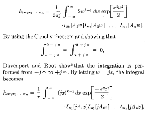

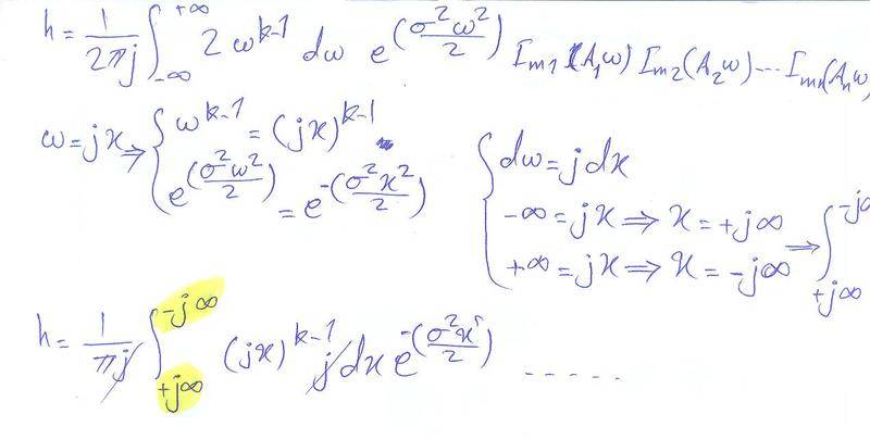

I want to change integral variable to jx it means (w=jx)
but as you see the bounds of integral are different from the book text , what is my mistake?
hat about the part that says: "by using the Cauchy theorem and showing that..."?
dear Simon
I didn't understand how can I use the Cauchy tip to solve this inconsistency?
It's a step you seemto have left out though.
I'll agree it looks like there's a minus sign missing. Maybe there's a typo? I can't actually read the image properly.
baby_1 said:
dear Simon
It allows you to perform the integral from [itex]\omega = -i\infty[/itex] to [itex]\omega = +i\infty[/itex], which on setting [itex]\omega = ix[/itex] becomes [itex]x = -\infty[/itex] to [itex]x = \infty[/itex].
