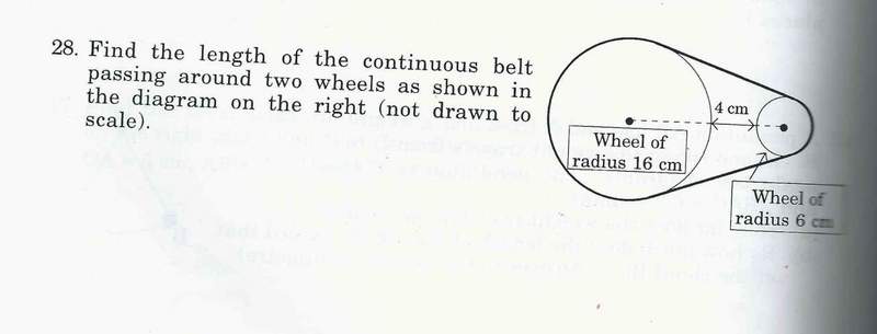

refer to question image
refer to question image again

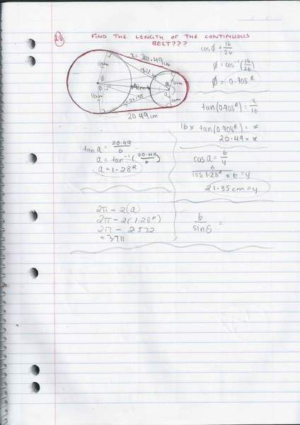

refer to working out image
This is my brothers maths homework. He normally doesn't use online methods to request help and this is his first time.

i was wondering how to get the inner angles of the big and small wheel.
i've been able to get 'alpha' and 'phi' but i don't know how to get 'theta' on the big wheel.
if you can explain how i can get that then i'll be able to get the smaller wheel angle and then find the major arc lengths of both wheels.
so first notice the part of band between the two wheels touches tangentially to both that means the radii that touch it both have measure pi/2 and are in fact parallel to one another.
if you extend the 6 cm radius a bit to 16 cm then you have a rectangle containing a right triangle with sides X cm, 10 cm and hypotenuse 26 cm. You can then compute its angles and go from there.
I didn't 21.49 cm for X. I got a nice integer number.
Thanks I got the answer of 125cm which I checked in the back of the answers and is right. The way you explained it helped.
