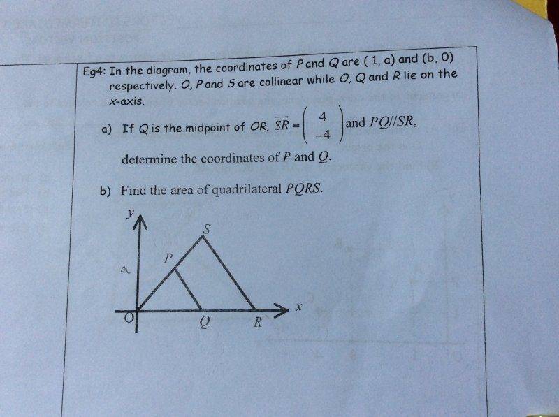

Dear Mentors and PF Helpers,
Here's the question:

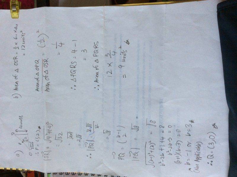

Here's my solutions:
Please let me know whether I'm right. Thank you
[/B]
Hi LiHJ. How would you justify saying PQ is half the length of SR?
Edit: the rest looks right, though you are a bit rough & ready with the geometry. PQRS shouldn't be designated using the Δ symbol! :)
Because the question mention that Q is the midpoint of OR and PQ is parallel to SR. So triangle OPQ is similar to triangle OSR. Therefore P is a midpoint of OS
Likes NascentOxygen
Thank you;)
