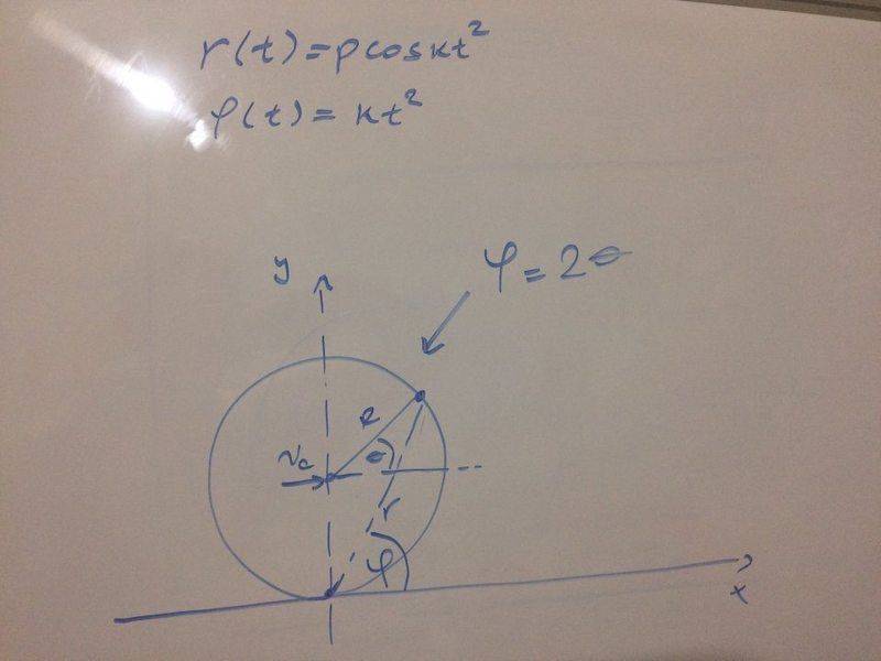

With the equations of motion in polar coordinates given by ##r(t)=pcos{kt^2}, φ(t)=kt^2## determine the velocity intensity of a point ##M## on the circumference of a cylinder which is rolling without friction on a horizontal plane at time ##t## is the velocity of the center of cylinder at time ##t## is ##v_c##
3. The Attempt at a Solution [/B]
I first drew a picture of a cylinder and noted that the angle ##φ## is the angle from the horizontal to the point ##M## and i need to use another angle which is more suited for this rolling motion and that would be the angle ##\theta## which is measured from the radius to the vertical.
From here ##\theta=2φ=2kt^2##. Since i know how the angle changes, i can calculate the angular velocity and acceleration. ##ω=\dot \theta = 4kt, α=\ddot \theta = 4k##. Since the function of ##r## is dependent only on ##cos(kt^2)## i gues what's in front must be the amplitude therefore the radius should be ##R=p/2##? Is this correct thinking?
The velocity and acceleration are ##v=wR=2pkt, a=Rα=2pk##, i can find the the ##a_n=8pk^2t^2## but how do i find the velocity at that point. Kinda stuck on that?

the angle φ is the angle from the horizontal to the point M
Not following that.
Where is the origin for these coordinates? Seems like it must be moving at the same velocity as the centre of the circle, and r varies between 0 and p, so I guess the origin is, at each instant, the point of contact and p is the diameter. That makes the reference frame non-inertial.
It also makes φ the angle M and the circle's centre subtend at the point of contact.

The problem does not have a diagram but i tried drawing it
Ok, that's what I deduced about your view from what you wrote. But the equations say r=p cos(φ), so where is p in your diagram?
Seems to me φ should be the angle to the vertical and p is the diameter of the circle.
What is the angular velocity at time t? So what is vc as a function of t?

Well my function of ##r## is at its peak when ##cos{kt^2}=1## so the p is a diameter and ##R=p/2##, oh yeah so because of this the angle must be measure from the vertical so that the ##p## part is met? If the equation was ##r(t)=psin{kt^2}## then it would be like this right?
My angluar velocity is then, since the angle ##\theta## is now the twice of ##\phi##, ##w=4kt##. ##v_c## is constant at all times so it is not dependent on ##t##?

Lets imagine this. At some point in time the velocity of the center of the cyliner is ##v_c##. I then conclude that the velocity of the top of the cylinder (the hightest point) must also have the velocity ##+v_c## and the lowest point ( the one where the contact is ) must have the velocity ##-v_c##. Therefore the change ##-2v_c## so there must be a point of zero velocity in between. Regarding that in a angle form of our chosen system i would conclude that the velocity of the point on the circumference is ##v_p=v_c*cos{\theta}##. Does that seem correct and if not, what seems wrong?

Well then is the point of contact is stationary at time ##t## and the centers speed is ##v_c## at time ##t## the only reasonable image of this would be that the highest point has a velocity of ##2v_c##. Then all the other points on the circumference would have a velocity of ##v_p=2v_ccosθ## where ##cosθR=h-p/2##, ##h## is the height of the point measured from the ground. This case includes the uppmost velocity of the cylinder at point ##t## which is ##v_p=2v_ccos{\pi /2}## but not sure about the velocity when ##h=p/2##

Sorry what i meant was ##R*cosθ=h-p/2## How did you get ##h=pcos^2{θ}##?

Instantaneously, the cylinder is rotating about what point? What is its rotation rate in terms of vc and p?
haruspex said:
You did not define θ so I had to guess from your vp formula.
Instantaneously, its rotating around the point of contact. Rotation rate? ##\frac{2v_c}{p}##? I am not sure what I am calculating now..

So if some point of the cylinder is at distance x from the point of contact with the ground, what is its speed?
haruspex said:
Right, and right.
##\frac{2v_c}{p}*\frac{h}{cosθ}##?
Right (again, guessing at your definition of θ), but you can express x in terms of θ and p, rather than θ and h.
