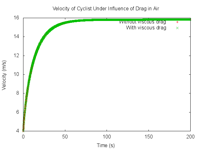

So I've gone through the problem numerically and the results that I'm getting are identical, regardless of whether or not I include the viscous term ## -\frac{\eta Av}{mh} ## in the differential equation.
So, without the viscous term,
[itex]\frac{dv}{dt}=\frac{P}{mv}-\frac{1}{2m}C\rho Av^{2}[/itex]​
While with the viscous term,
[itex]\frac{dv}{dt}=\frac{P}{mv}-\frac{1}{2m}C\rho Av^{2} -\frac{\eta}{mh}Av[/itex]​
I've gone through a couple of scenarios:
1) Cyclist in air with the following constants:
## P = 400 W, m = 70kg, C = 0.5, \rho = 1.225 kg/m^{2}, A = 0.33 m^{2}, \eta = 2*10^{-5} Pas, h = 1.5 m, v_{0} = 4 m/s^{2} ##
Here, my calculated limiting velocity is ## 15.818174 m/s^{2} ## for both viscous and non-viscous considerations.

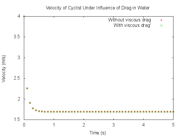

2) Cyclist in water with the following constants:
## P = 400 W, m = 70kg, C = 0.5, \rho = 1000 kg/m^{2}, A = 0.33 m^{2}, \eta = 1*10^{-3} Pas, h = 1.5 m, v_{0} = 4 m/s^{2} ##.
In this case, the limiting velocity due without viscous drag is ## 1.692526 m/s^{2} ##, while with viscous drag, it is: ## 1.692525 m/s^{2} ##.
I've worked out the limiting velocities as you pointed out by hand, mfb, and everything seems to check out...
Would it be correct to consider the Reynold's number in these scenarios? Since the Reynold's number in both of these scenarios is quite large, the viscous drag is negligeable.
Right.
