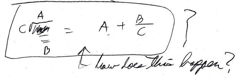

So, how can a graph have both horizontal and oblique asymptotes?
Also, what I really want to know is why the operations for finding these things work.
why does dividing the quotient out give me the asymptote?
and why... well, see the attached image for this one as I have no way to type it.
why is it that when we get y= c + a/b is it that c is the oblique asymptote? or should c be a constant the horizontal asymptote?
and i still don't get why when the equation is proper 0 is the horizontal asymptote.
please explain this

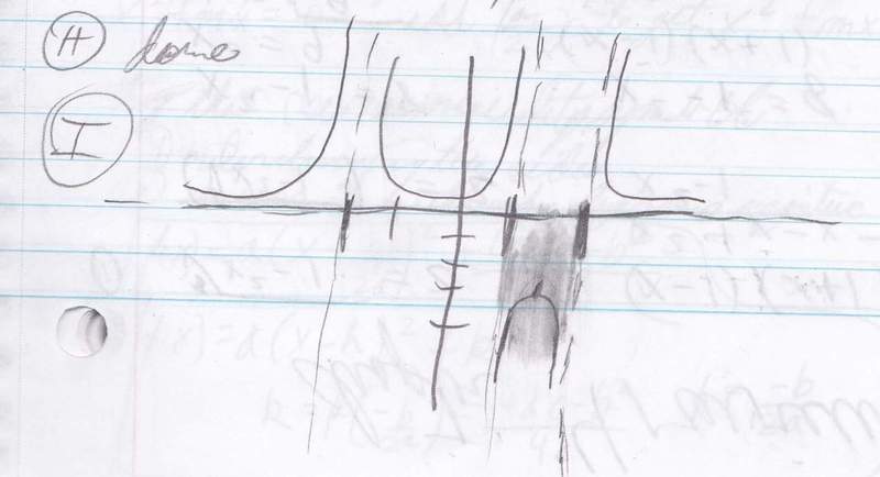

such a graph need not be drawn. just stick a horizontal asymptote and a vertical one or two or even and oblique in there and draw some lines that adhere to them. as for finding an equation of one, i will provide that later. i will have to look them up as it's been a while.
this would probably be a good example of an equation with both.
3/((x-1)(x^2-4))
an image of it is attached. it is not an exact image.
3/((x-1)(x^2-4))
No rational function has both horizontal and oblique asymptotes.
The function y = 3/((x-1)(x^2-4)), for which you sketched a graph, has 3 vertical asymptotes and one horizontal asymptote.

A proper rational function is the quotient of two polynomials p(x)/q(x), where the degree of the numerator is less than the degree of the denominator.
When the degree of p(x) is less than the degree of q(x) (e.g., f(x) = x/(x^2 + 1)) the horizontal asymptote is the x-axis. The reason for this is that as x gets very large or very negative, the denominator grows large (or very negative) more quickly than the numerator, so the whole fraction gets closer to zero.
When the degree of p(x) equals the degree of q(x), you can perform polynomial long division to write the function as a polynomial plus a proper rational function. The division that is done is similar to what you show in your attachment.
Let's look at a simple example with just numbers: 7 divided by 3. Back when you were first learning division you probably would have done something like this:
Code:
...___2 R 1
3) 7
IOW, 3 goes into 7 two times, with a remainder of 1
So 7 = 2 * 3 + 1
If you divide both sides of this equation by 3, you get
7/3 = 2 + 1/3
You get an integer (2) plus a rational number (1/3)
Polynomial long division works a lot like this.
If your (improper) rational function is g(x) = (x + 3)/(x + 1), you can do poly. long division to get
(x + 3)/(x + 1) = 1 + 2/(x + 1), a polynomial (1) plus a proper rational function (2/(x + 1))
You can check that this is correct by multiplying both sides of the equation above by x + 1, which gives you
x + 3 = 1*(x + 1) + 2 = x + 1 + 2 = x + 3, which is identically true.
This particular rational function, g(x) = 1 + 2/(x + 1) has a horizontal asymptote: the line y = 1. As x gets very large or very negative, the 2/(x + 1) part approaches 0, so that the graph gets closer and closer to the line y = 1.
If the degree of the numerator in an improper rational function is one more than the degree of the denominator, division will produce a polynomial of the form kx plus a proper rational function. In this case, there is an oblique asymptote, the line y = kx.
Hopefully, this covers the how and why you're asking about.
