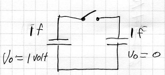

There are two capacitors, 1 farad each, connected by a switch. The initial voltage of one capacitor is 1 volt. At t0, the switch is closed.
What is the system energy before closing the switch
What is the system energy, of both capacitors after closing the switch.
What is the difference in stored energy and why.
V = Q/C
E = (1/2)CV^2
initial energy = (1/2) (1) (1)^2 = 1/2 J
Q = CV = (1)(1) = 1 c
After switch closes, the charge is distributed over both capacitors, so each capacitor has a charge of 1/2 c
voltage is Q/C = 1/2 / 1 = 1/2 V
Energy in each cap is (1/2) (1) (1/2)^2 = 1/8
Total stored energy is 1/2 + 1/8 = 1/4
I lost 1/4 J of energy ??
  • Hand-drawn circuit schematic on grid paper: two 1 f capacitors joined by a switch across the top, with the left capacitor labelled V0 = 1 volt and the right labelled V0 = 0.

barryj said:
So, where did it go?
Can you think of any plausible mechanisms for removing/dissipating the energy?
