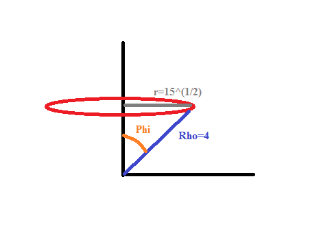

why is that? I've reasoned the bound this way:
Diagram of spherical coordinates with a vertical z-axis and horizontal x-axis; a blue line of length Rho=4 makes angle Phi from the vertical, and a red circle at its tip has radius r=15^(1/2).
Then [tex]4 \sin \phi=\sqrt[]{15}[/tex]
  • Sketch of spherical coordinates with a vertical z-axis and horizontal x-axis; a blue line of length Rho=4 makes angle Phi from the vertical, and a red circle at height is labelled r=15^(1/2).

That gives the same limits because you have, equivalently,
\begin{align*}
\cos \phi &= \frac{1}{4} \\
\sin \phi &= \sqrt{1-\left(\frac{1}{4}\right)^2} = \frac{\sqrt{15}}{4} \\
\tan \phi &= \frac{\sin\phi}{\cos\phi} = \sqrt{15}
\end{align*}
