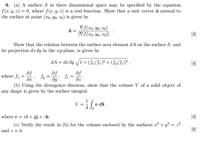

A surface S in three dimensional space may be specified by the equation
f(x, y, z) = 0, where f(x, y, z) is a real function. Show that a unit vector nˆ normal to
the surface at point (x0, y0, z0) is given by
Typeset problem 9 from a university exam: part (a) asks to show that the unit normal n-hat equals grad f over its magnitude and that dA = dx dy sqrt(1 + (fx/fz)^2 + (fy/fz)^2); part (b) asks to show the volume is V = (1/3) integral over S of r dot dS; part (c) asks to verify this for the volume enclosed by x^2 + y^2 = z^2 and z = h.
r = (x, y, z)
∇f = 2(x, y, -z)
n = 1/r (x, y, -z)
dS = dx dy √[1 + (x/z)2 + (y/z)2] (1/r) (x, y, -z)
When i take r (dot) dS it gives x2 + y2 - z2 which = 0..
Method 2 (Cylindrical Coordinates)
dS = n (r dr d∅)
but this still gives 0 when n (dot) r
... which is correct for that part of the surface. But there's another part, governed by z = h.
Ah i see, I missed out that surface entirely! (Which happens to be simply a disc)
Since divergence theorem only works for closed volumes.
