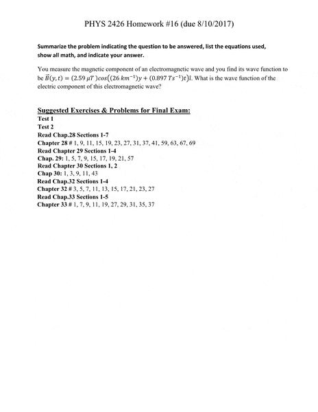

Ignore the suggested Problems if you will. If you can't see the image give me a shout and I'll give the problem statement here.
B(y,t)=Bmaxcos(Ky-Wt)
Wavelength=2pi/kn
W=2pi*Frequency
V=Emax/Bmax
V=Walength*Frequency
So calculating the Wavelength is no problem. We get .00024166m for the Wavelength
The problem comes when we try to get the frequency from the stated Angular Frequency, which strangely seems to be multiplied by the Bmax to attain a unit of Tesla Inverse Seconds. Is it? And if it is does that affect our calculation for Wavelength?

The question doesn't ask for the wavelength. The frequency is the same for both the electric and magnetic component of the wave. The relationship between the electric and magnetic component of a plane wave is relatively simple to derive using the Maxwell-Faraday equation
$$\nabla\times\mathbf{E}=-\frac{\partial\mathbf{B}}{\partial t}$$
Since the electric field is parallel to both the magnetic field (in the x-direction here) and the direction of wave propagation (in the y-direction here), the above equation reduces to
$$\frac{\partial E_{z}}{\partial y}=-\frac{\partial B_{x}}{\partial t}$$
I assume a similar relation is in your textbook somewhere. Can you use this to find ##\mathbf{E}##?

Alright so this means that the time dependent component of the Magnetic Field is equivalent to the negative of the distance dependent component of the Electric Field?
Regardless can you answer me this: The time dependent component of the electric field we're given is the angular frequency multiplied by the amplitude of the B field?
RememberYourAngles said:
Alright so this means that the time dependent component of the Magnetic Field is equivalent to the distance dependent component of the Electric Field?
Their derivatives are equivalent. To start, can you work out the derivative on the right hand side of the equation using your formula for B?
Alright so If we take the partial derivative with respect to time of the wave function of the B field, we're left only with the distance dependent component.
And this is equivalent to the negative of the partial derivative with respect to distance of the wave function of the E field, which leaves us only with the time dependent component.
Is this an accurate statement?
So the right hand side gives us -2.32323sin((26000m^-1)y+((.897Ts^-1)t)I hat
That gives us the partial derivative with respect to distance of the E field.
What do we do from here?
Is there such a thing as a partial integral?

No, time will still be in the argument of the trig function.
And this is equivalent to the partial derivative with respect to distance of the of the wave function of the E field, which leaves us only with the time dependent component.
No, distance will be here too. It appears that you are not very familiar with partial differential equations so I will do the right hand side.
$$-\frac{\partial B_{x}}{\partial t}=(2.59\mu T)(0.897Ts^{-1})\text{sin}((26km^{-1})y+(0.897Ts^{-1})t)=(2.32MT/s)\text{sin}((26km^{-1})y+(0.897Ts^{-1})t)$$

Alright so do we take a partial integral with respect to distance to get the E equation?
Ok great, aside from missing units that matches my answer.
You can just integrate this with respect to y now.

I do have one last question. Shouldn't the prefix be 2.32 micro tesla? Not 2.32 mega tesla?
No because we are multiplying the prefix ##\mu=10^{-6}## with the prefix ##T=10^{12}## which equals ##M=10^{6}##.
Wait T was a prefix and not Tesla?
Oh right T=Tera
Man that means my original idea would've worked.
Still. Thanks.
NFuller said:
I am a bit curious how he expects this to make sense without using calculus. Maybe there is a canned equation he gave you somewhere. Also, let us know your final answer when you get it so it can help others on the forum.
The given magnetic field is of the form $$\vec{B}(y,t) = B_0 ~\hat{i}\cos((k~y+\omega~t)$$It represents an EM wave traveling in the negative y-direction as seen by the relative "+" sign in the phase. The associated electric field is in phase with the magnetic field, it has magnitude ##c B_0##, it is orthogonal to the B-field such that ##\vec{E} \times \vec{B}## is in the direction of propagation, in this case ##\hat{j}##. Putting it all together gives $$\vec{E}(y,t) = -cB_0 ~\hat{k}\cos((k~y+\omega~t)$$
All this requires elementary understanding of EM wave properties without need for calculus.
