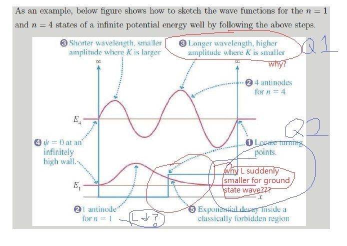

Q.1Why when the particle's kinetic energy is smaller, the wave has longer wavelength and higher amplitude?
Q.2 Why the length of box decrease in ground state?
<All in attachment>
Q.1 wavenumber k= \frac{\sqrt{2m(U-E)}}{\hbar}, isn't it?
so KE decreases, wavenumber decreases, wavelength increases?
But isn't the amplitude just (2/L)^(1/2), from the normalization techinque?
Q.2 I really do not know why the box suddenly "contract" in the ground state.
can someone tell me why the amplitude of wave is affected by kinetic energy(E-U)?
