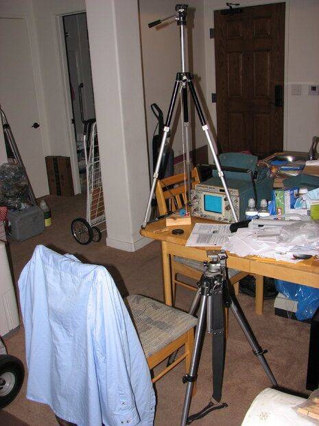

First, many thanks to @Delta2 for posting the video to YouTube!
Here is a slow-motion video, 10% speed, showing the voltage waveform along with the magnet orientation relative to the coil.
The magnet is marked "N" at it's North pole. A bit easier to see is the end of the support string pokes out over the North pole of the magnet.
The waveform dip between the double peaks occurs when the magnet is perpendicular to, approximately on, the coil axis.
The waveform amplitude variations are from the variation of magnet speed at beginnning and end, and the slight off-axis drift of the magnet. These are most noticable near the start and end of the clip where the scope didn't trigger.
--(insert movie MVI_03-A.wmv)
SCOPE Tektronix 465
  • Vert DC 10mV/div (+-40mV full screen)
  • Horiz 50mS/div (500ms/sweep)
  • Trigger AC+, slightly below 0
PROBE:
  • TEK P6001 1X, one-times probe
  • measured at probe tip as connected to scope
    • C=65.8pF, R=999K Ohm
INDUCTOR:
  • L= 531uH
  • R= 4.33 Ohm
  • Winding
    • O.D. 1.2in.
    • Length 0.48in.
    • Wire 30AWG, Dia. over insulation: 0.018in.
    • Spool
      • Flange thickness: 0.050in.
      • Center bore: 0.375in.
    • Winding direction: CW as viewed
      • Connection:
      • Start (inner) to Scope
      • End (outer) to Gnd.
LCR Meter:
  • BK PRECISION Model 875A LCR METER
CAMERA:
  • CANON S3IS
    • Focal Length 6mm (wide angle, 35mm film equivalent 36mm)
    • Focus and Exposure: Auto
As a 'Bonus?', here is shot of the Work Station; the kitchen table. The camera was on the empty tripod on the lower right. The magnet was hung from the upper tripod with cotton twine, which was manually twisted up to provide magnet rotation.
--(insert still Work_Station.JPG)
Cheers,
Tom
