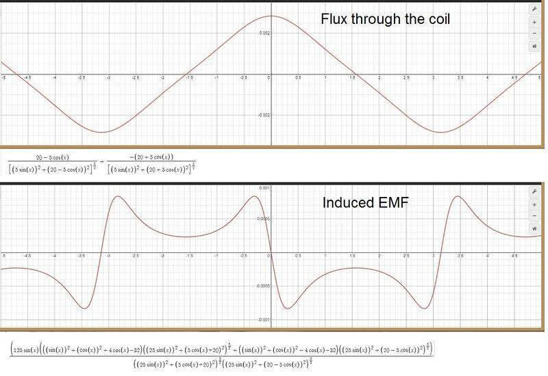

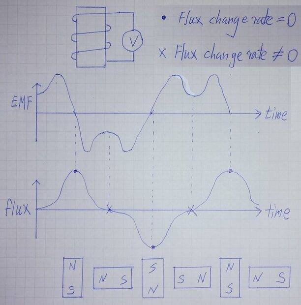

alan123hk
- 817
- 450
I very much agree with this. A slight negligence or lack of careful thinking due to laziness makes it easy to draw wrong conclusions based on intuitive analysis. I have made this mistake before. Intuition leads me to believe that when the poles are to the sides, and equidistant from the coil, the rate of change of magnetic flux should be zero, but this is not the case.Delta2 said:A qualitative /intuitive approach is always good but sometimes it leads us to the wrong conclusions and such is the case here
Fortunately, Charles Link's excellent analysis post #107 quickly pointed out this misunderstanding.Charles Link said:The voltage is caused by the time derivative of the flux. When the poles are to the sides, and equidistant from the coil, the total flux is zero, but the derivative can be near maximum. This is where you observe the slight dip between the peaks, which occur just before and just after this position

alan123hk said:I very much agree with this. A slight negligence or lack of careful thinking due to laziness makes it easy to draw wrong conclusions based on intuitive analysis. I have made this mistake before. Intuition leads me to believe that when the poles are to the sides, and equidistant from the coil, the rate of change of magnetic flux should be zero, but this is not the case. Fortunately, the excellent analysis of post #107 quickly pointed out this misunderstanding.
Thanks for the graphical representation. It's awesome. Now anxiously awaiting Tom's video.
Also one thing evident from the flux graph is that the induced emf is 0 when magnetic field strength is uniform at the peaks albeit for a very short period of time. Of course these are the magnetic pole tips.
