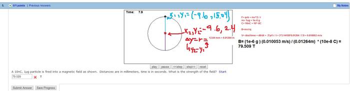

A 10nC, 1µg particle is fired into a magnetic field as shown. Distances are in millimeters, time is in seconds. What is the strength of the field? (See my picture for additional information and my worked solution)
f= mv^2 /r F(from B field) = qvb
see picture for my work. I don't see what I am doing wrong.
Hello Erwin,
Wow, you sure have a wide screen. Doesn't prevent you from falling into the trap of forgetting to use proper units. Your expression for B is quite correct. Convert one of the factors to SI units and you are in business.
Hint: 78 T is incredibly huge for a magnetic field strength.
