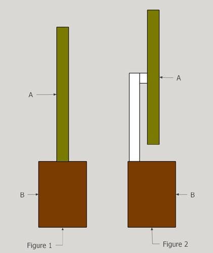

Say Object-A weighs 100 lbs.
In Figure-1, it's obvious that the weight distribution is even along the bottom edge of Rectangle-B.
In Figure-2, ignoring the weight of the white objects, is the weight distribution exactly the same along the bottom edge of Rectangle-B as it is in Figure-1?
What do you think, and why? Are you familiar with how to draw Free Body Diagrams (FBDs) and sum forces and moments?

Hint: The moments around the center of mass must balance in both cases.

This is not correct. The force distribution along the bottom edge of rectangle B in Figure 1 is not uniform. It is higher toward the center than towards the edges.
Have you ever had a course in calculus? If you are talking about the force distribution along the bottom edge, are you comfortable with the idea that the force distribution is described by the local value of the upward force per unit width?

Let me reword my statement.
"In Figure-1, if 2 small blocks of wood are placed underneath Rectangle-B, one flush with the left edge and the other flush with the right edge, then the weight pressing on each block would be identical assuming the load is directly in the center of Rectangle-B."
Will the same condition exist in Figure-2?

BTW, I think I asked a couple times what you think about the problem, but I don't think you replied to that. I know what I think intuitively and with just basic visualization of what would happen, but I'd need to do the FBDs and calculations to be sure.
Can you say what you feel intuitively would happen (before you leave us)? Thanks.
