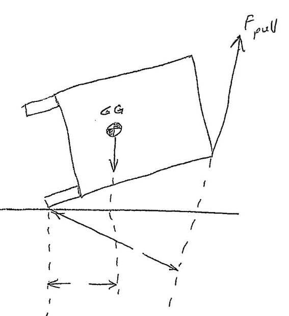

Good Afternoon-
I apologize if my post is on the wrong forum.... I have been searching & searching for an answer & a theory on weight transfer-
Bare with me, hope I can make this make sense.... I am starting my training to work on a Rotator Wrecker which is a tow truck equipped with 360 deg rotating boom that can be used as a crane.
During any operation you need to know how much a vehicle weighs..... When a vehicle has landed on its passenger side, the vehicle needs to be uprighted back onto its tires. During this operation you will be flipping the car back over and will be using the passenger side tires (front & back) as a fulcrum. Since the vehicle will not be completely suspended in the air, the boom will not be lifting 100% of the vehicles weight.
During this lift, depending on the angle of the vehicle will determine how much weight is being lifted. (IE: 15 Degrees = ?? % of Vehicle Weight / 30 Degrees = ?? % of Vehicle Weight / 45 Degrees = ?? % of Vehicle Weight ) During the lift, as vehicles is lifted up, the weight will get lighter or heavier??
How do I figure out how much weight or % of vehicles weight am I lifting since the weight transfer will vary depending on the angle of the vehicle due to the fact that one side of the vehicle is kept in contact with the ground-
I been told that there are ballpark numbers out in the tow recovery world but I
want to know the theory / physics of why this is happening?
If anyone knows how to explain this or if you can point me to the direction of where I can find the info out myself, that would be great!! Thank You & apologize for such a long drawn out question....

The vehicle will roll or hinge over a fulcrum line, that joins the two tyres that contact the ground. The forces will depend on how you attach the lifting wire, and the direction of the pull.
The weight that must be lifted will depend on the position of the centre of mass of the vehicle. The force needed will start out at about half the vehicle weight, it will reduce to zero, before the forces change direction and the vehicle falls for the second half of the roll.
You must control that second part of the roll, after the forces reverse, and begin to increase again.
The forces will rise to a maximum of about half the vehicle weight, as it lands on its wheels. That is when you will wish you had applied the emergency brake, and chocked the wheels. If you do not control the descent and landing, it may continue to roll over onto the other side. That is especially true when the ground has a slight side slope.

How about doing a Free Body Diagram?
You have to know where the CG is located, where the pulling force is applied, and at which angle. Then, you have two reaction forces at the tires: one vertical force from the ground and a lateral one from tire friction.

It seems you are lifting the roof of the vehicle upwards, to put it back on its wheels. There is little structure to attach to on the roof, so you should be attaching to the wheels or axle and pulling horizontally.
WreckerOp911 said:
I am looking for explanation / physics behind weight transfer and what the ballpark percentages that can be assigned to the angle.
As I suggested earlier, get a brick, and roll it over with your hand. Find the balance point. That is a good way to get a feel for, and see how, the weight is transferred during a roll.
If a vehicle was 2.5 m, (8 ft), wide and high, with the centre of mass 1.25 m, (4 ft), above the road, then the weight at each end of the roll would be half the weight of the vehicle.
There would be a tipping point, with zero-weight, at 45°.

You need to learn Free Body Diagrams (FBDs) in order to figure this out. An FBD shows the contact point between the vehicle and ground, the center of mass of the vehicle, and the location and direction of the pull. An example FBD is shown below.
In this example, the cable is attached somewhere near the chassis and wrapped around the side of the vehicle. The pulling force is at the point where the cable separates from the vehicle. The center of gravity (CG) is the location of the center of mass of the vehicle. A full cement truck has a high CG, an empty semi trailer has a low CG. For the purpose of the FBD, the entire weight of the vehicle is assumed to be at the CG.
The weight of the vehicle is multiplied by the distance from the CG to the contact point. Weight in pounds times distance in feet results in a moment in ft-lbs. A 20,000 lb vehicle with a CG distance of 4 feet will have a moment of 80,000 ft-lbs.
The pull force can be in any direction. The pull force creates a moment in the opposite direction of the moment due to the weight of the vehicle. When the pull moment is greater than the CG moment, the vehicle starts to raise. The task is to find the pull force to raise the vehicle. First find the distance from the pull force to the contact point. The pull force distance is the perpendicular distance from the line of pull force to the contact point. If the pull force is vertical or horizontal, it is easy to measure. If not, you need to be very careful to get it right.
The calculation is: Pull Force = Weight of vehicle * CG Distance / Pull force distance
Sample calculation:
Weight of vehicle = 20,000 lbs
CG distance = 4 feet
Pull force distance = 9 feet
Pull force = 20,000 X 4 / 9 = 8,900 lbs
As the vehicle raises, the CG distance decreases. When the CG is directly over the contact point, the pull force decreases to zero.
