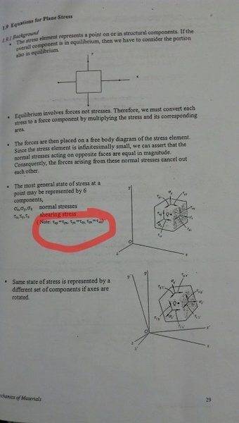

Sorry, I have another notes here... I couldn't understand why the (tau)_xy could be = (tau)_yx? Why should they be the same?
I recommended references that contain the same kind of derivation that is in virtually every textbook. And I already alluded to a balance of moments. The rest is up to you to work out.
Do you have any notes or online notes that explain further on this part? I have tried to search online , but no avail..
