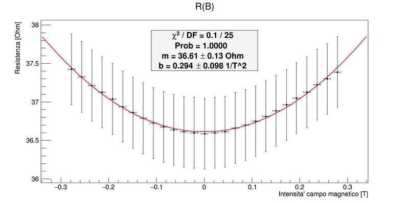

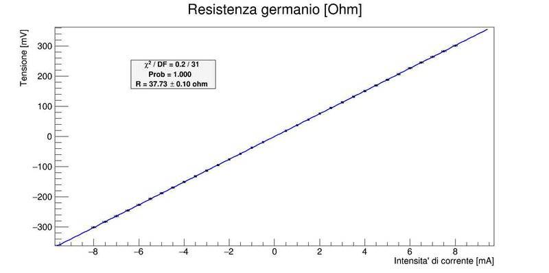

Hi, in laboratory i had a sample of Ge with p-doping. In a first place i have done different measure V vs I (first image)
Then i insert the sample in a magnetic field perpendicular to the sample.
And i have done measure of V vs B (with a fixed current at 8 mA) and i obtained the second image.
As you can see at B = 0 the R is lower than the resistance of the first graph. Why ?

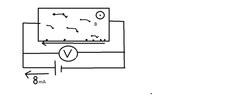

I suppose this third image
The is an accumolation of positive charges at right and so we measure a lower Voltage with a lower resistance
Can be this correct?
It looks like the top of your error bar at B=0 is close to what you measured in the first test. Why are the error bars so large?
Also, temperature will affect the "resistance" reading. How did you control for temperature?
Yes is close but with a Z test alpha 5% the two values are not compatible. The error bars are large due to the instruments. The temperature is the same.
What do you think about my idea?
