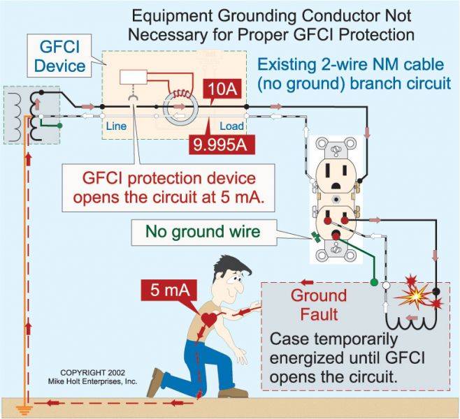

  • #33
OmCheeto said:
I wrote up a REALLY long chastisement post for Greg, because I still didn't understand how GFCI's could work without a ground wire, but decided that my post was in error, as they apparently do work.
I believe they sense the current in the Hot and Neutral wires, and if there is a difference of more than the threshold, they trip. It seems like I learned that a while back when I had the same question as you. I haven't looked up the circuit, though.
  • #34
OmCheeto said:
In my defense, it has been ≈30 years since I last studied GFCI, and I don't think the internets, as we know it now, existed.
Though, after I thought about it some more, I think I may have understood how they worked, but have forgotten, in the meanwhile.
A picture may be helpful in remembering.
image compliments of http://www.ecmweb.com/basics/how-gfcis-work

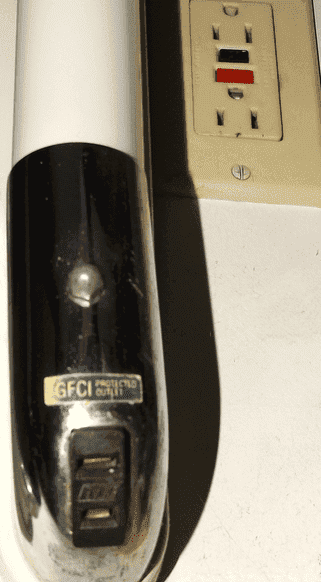

My vintage 1945 bathroom vanity fixture, upgraded in about 1992.
I'm pretty sure I would not have done that, had I known it wouldn't work.
  • #36
Just think of it as having made it possible for two people to be protected at the same time. :oldbiggrin:

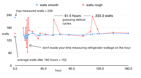

Funny thing is, I never replaced the wiring to two outlets, which are in my kitchen.
About a month ago, whilst doing some "load testing", I discovered that my refrigerator has a ground fault when I open the freezer door.
Update:
I pulled the freezer light bulb out yesterday, and then* plugged the fridge into a GFCI outlet. With the door open, it did not trip the circuit. Then I reinstalled the light bulb. Opening and closing the door 100 times does not trip the circuit.
I guess it's not broken after all.
*In hindsight, I probably should have done this in a different order.
  • #44
Is it on a GFCI all the time?
If you can catch it in a defrost cycle check it then.
I had a faulted defrost heater that tripped the GFCI once a day. Took a while to figure that one out.
Locate the defrost timer, they usually have provision for manual advance.
  • #45

  • #47
Nope. Only briefly for load testing, during the great "Ideas for refrigerator door design" thread.
Very low probability, IMHO.
Based on:
1. It only happened when I opened the freezer door, and not the refrigerator door.
2. The defrost cycle only happens every, (pfoogle, pfoogle, pfoogle) 61.5 hours.​
ps. It's still plugged into the GFCI, and every time I walk by it, I open the freezer door. Nada.
pps. I also did the old; "Lets grab hold of the metal parts of the stove and the refrigerator at the same time with the freezer door open, and see if Om dies" experiment. No luck. Not even a tingle.

To me, electrical safety is ingrained, and should be shared extensively.
But, we really do need to stay on topic.
The latest:
KCBD
July 14, 2017(two days ago!)
The report from the U.S. Consumer Product Safety Commission and the Lovington Police Department says she plugged her cell phone into an extension cord, which was plugged into a non-GFCI, non-grounded bathroom wall outlet.
The report goes on to say the phone was never immersed in water.
Officials say Coe took precautions to keep the connection of the cords dry, it is believed she was not aware of a significant area of fraying to the extension cord. Evidence shows she touched the frayed extension cord while she was in the bathtub, which had water in it.
Lessons:
1. Even if you have 100 year old, two conductor wiring, a GFCI outlet will protect you.
2. Send all worn out extension cords to OmCheeto. He knows how to repair and/or recycle them.
3. A ground wire would not have saved her life, IMHO.
4. Electrical "stuff" now spans about 100 years. The old metal cased stuff protected you by having a "ground wire". Most new stuff is not made of metal, and the ground wire is probably kept around for nostalgic peeps, like me.​
