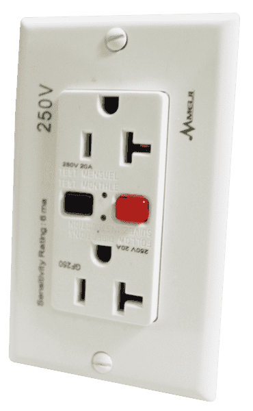

Being a resident of Texas, I can verify the following. First, not all bathroom outlets have GFCI, in spite of regulations to the contrary. Secondly, she may have submerged both her hand, and the phone, since electrical safety has never been a major priority in this area. Beyond that, she could have had a 'generic' phone charger, of almost any manufacture, but her parents would have denied that, for reasons of liability. Finally, exactly what occurred, and why, will never be known, as there is a suit for wrongful death in the works, and the story will conform to whatever the lawyer suggests. It's probably tragic, but the truth will remain hidden.
  • #71
Note that some may have GFCI and not realize it. My house has an odd "house GFCI" circuit, which appears to be based on one GFCI receptacle in the garage wired in series with the rest of the "wet" receptacles (3 bathrooms, 2 outside).
  • #72
Yep. I have one in the bathroom that's also wired to an outside receptacle.

  • #87
Most of the resistance that saves you from electrocution from occasional contact with 110 or 240 V comes from dry skin. If the skin is wet the voltage required to get a lethal current is a lot lower. People have killed themselves by inserting 9V batteries into body openings. It might be that 5V is enough with a wet hand when the rest of the body is probably grounded via wet skin, water and the grounded / Earthed pipework to the bath.
  • #88
CWatters said:
it makes more sense for the washing machine to go in the bathroom on the middle floor rather than in the kitchen on the ground floor.
i always wondered why aren't the washer and dryer in or adjacent the bedroom, where the laundry is generated ? That's where i change clothes & bedding, and towels are in the bathroom which is always near bedrooms. I plan to relocate my laundry close to bedroom and bath. Sigh, so many projects so little time !
That mighta made sense long ago when they were expensive. Nowadays they're under ten bucks and it's false economy.
Capacitance of long wires daisy-chaining them like that can give false trips especially when it's wet (dielectric constant of water is ~80) .
I have one GFCI in a panel that a certain electronic fluorescent ballast will trip just often enough to be a nuisance . It feeds the bathroom and the garage.
I prefer to use individual GFCI receptacles everywhere they're needed so will be replacing that breaker with a plain one. That way , for example, something in the bathroom won't kill power to the garage and defrost a freezer out there. Good explanation of how they work here...
