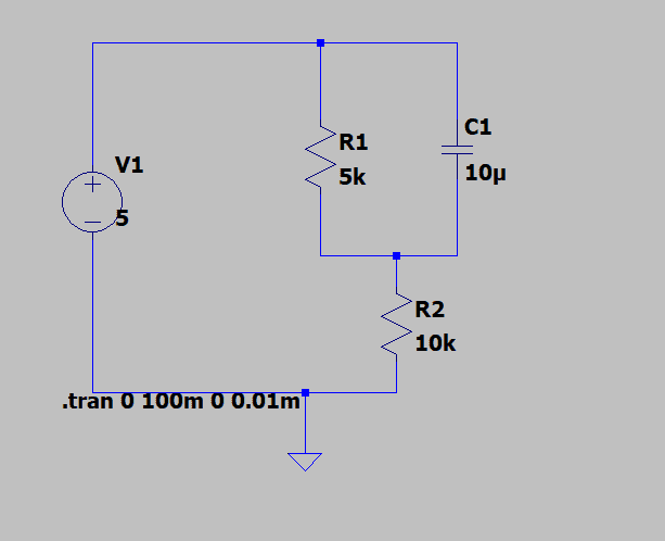

Ok i understand that the circuit is wrong.
Schematic of a DC circuit in LTspice: 5 V source V1 feeds a node with R1 = 5k in parallel with C1 = 10µ; that node connects through R2 = 10k to ground, with a .tran 0 100m 0 0.01m directive.
I am going wrong every time i analyze a circuit, I have slightly modified the circuit
Here i have applied DC 5V.
Step1: When 5V applied the capacitor is initially discharged that is 0V, hence it is short circuit the current flowing will be
i = 5 / 10k = 0.5mA.
Step2: The capacitor slowly charges with time constant of R1*C1 = 5k*10uF = 0.05 seconds
V = 5(1 - e^(-t/0.05))
Step3: When the capacitor is fully charged, the capacitor is open circuit hence the current is
i = 5 /(5 + 10)k = 5/15k = 0.33mA.
Is my analysis correct?
I don't think that is correct. There are two resistors in the circuit, which affects the charging/discharging behavior and time constant.
Can you write the KCL equations for this circuit and solve them to find out the actual time constant?
For an LTspice simulation, the 5 volt DC supply will cause the capacitor to have an initial operating point before the simulation starts of;
Vc = 5 volts * 10k / ( 5k + 10k ) = 3.333 V.
Now you have the series resistor, R2 = 10k, you can use a voltage pulse to simulate the capacitor starting at zero and charging exponentially towards 3.333 volts.
V = 5(1 - e^(-t/0.05))Is my analysis correct?
No - the used time constant is NOT correct.
Simple trick: Ask yourself about which resistor combinaton the C will be discharged, when the voltage source is replaced by a short circuit.
If you understand Thevenin equivalent circuits, then you will immediately understand the correct solution to the current limit and voltage limit with the V1 and the Resistor network reduced to a single Rth value and a Vth value.

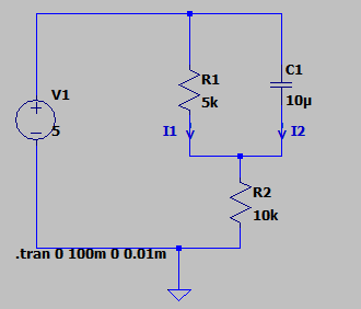

I am struck up at solving the below integral equation for current i2.
Three typeset circuit equations: V1 - i1R1 - (i1 + i2)R2 = 0 (eq1); i1R1 = (1/C) integral of i2 dt (eq2); (1 + R2/R1)(1/C) integral of i2 dt + i2R2 = V1.
Handwritten-style typeset derivation of a circuit equation: ((1+R2/R1)∫i2dt)/C + i2R2 = V1, then (1+R2/R1)i2 + (di2/dt)R2 = 0, then (1+R2/R1)i2/(R2C) + (di2/dt) = 0, followed by i2 = e^(-kt) and k = (1+R2/R1)/(R2C).
The equation is getting complicated.

First of all, great work doing KVL equations, those look good. Except when you take the derivative of both sides, ## V1 ## doesn't go away, unless it's really a constant value (always, from the big bang until the heat death of the universe). So that should be ## \frac{dV1}{dt} ##.
However, the time constant of the circuit doesn't depend on the driving function, so you're either really smart and didn't tell us, or you were lucky. Anyway, your equation isn't complicated, it's essentially done.
So, you know ## i_2 = e^{-kt} ## what is the time constant for ## i_2 ## then?
BTW, most EEs would write ## \frac{(1+\frac{R2}{R1})}{R2} = \frac{R1+R2}{R1R2} = \frac{1}{R1||R2} ##. Sometimes things that look complicated just haven't been expressed in a simple way. With practice you will learn more shortcuts and standard equation formats so that things are easier to do and/or understand.
I was worried of the calculation of the voltage across the capacitor,
Handwritten derivation of the capacitor voltage Vc in a circuit with resistors R1 and R2, ending with Vc = (V - R1R2Ce^(-kt)) / (R1+R2) where k = (R1+R2)/(R1R2C).
The time constant is k = (R1 + R2)/(R1R2C)
Yes i will try to solve using Thevenin, thank you all for support, i could solve one equation.
In ## e^{-\frac{t}{\tau}} ##, the time constant is ##\tau##. The argument for the exp function must be dimensionless.
The time constant is 1/k = R1R2C/(R1+R2) = (R1||R2)*C seconds.
