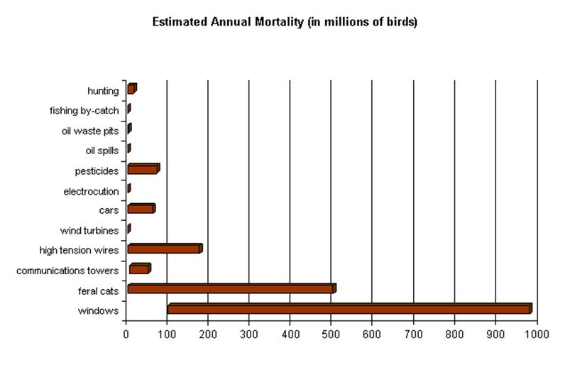

The real problem with wind is that it is a really bad idea in general. I ran across a rather interesting post on a different forum about this topic that I'd like to repost.
The wind power industry is the biggest scam to come out of the "greening" movement yet. "Oh, wind power is the future!" - bull****, wind power is a convenient distraction that is going to make a few people very rich before the powers-that-be realize they've been completely had.
Wind power has one essential flaw that makes it useless as a primary power generation tool - it has no capacity for storage and can supply only peak-demand alternatives. Even in places where the wind blows continuously and rotors continually turn, the system does not always function at peak capacity, which makes it totally unreliable. The only way wind energy is useful is to take the load off other power generation systems by throttling back the primary systems and allowing the power generated from wind turbines to absorb the slack when it is available. When the wind systems drop in production capacity, primary systems again must take up the slack. It is useful as an alternative to reduce demand on larger, reliable facilities, but that's it.
Now, take a long hard look at the ecological impact of wind power generation. Oh sure, there are no CO2 emissions from wind power, but what about other factors? Must like the idiotic move towards biofuels, which decimate arable land that could be used more productively to generate food, wind power generation leaves a massive and permanent ecological footprint. Wind farms, in addition to taking up valuable land space that could be used for all kinds of things (including preservation and conservation) has a large impact on local bird populations. Some preliminary studies have found significant impacts on bird populations, particularly in migratory routes, as a result of bird strikes at wind generation farms.
It's an inefficient red herring designed to do nothing but make money on the grants given to construct it, and then vanish into the night.
There are two forms of efficient, economically practical, and ecologically sustainable power generation known to man at present: hydroelectric, and nuclear. The sooner the do-gooders at Greenpeace, Sierra Club, etc get that through their thick skulls, the better off we'll all be. Solar is efficient only for small-scale projects, and the production cost is so significant that it isn't a feasible solution - though it will be when someone finally sorts out biological solar power generation on a commercial scale.
Most "environmentalists" and proponents of "green technology" have their hearts in the right place, but they don't have a ****ing clue when it comes to the technical aspects of these projects and it is absolutely infuriating. The idea that wind generation can replace current coal-fired facilities and therefore affect climate change is completely and utterly laughable.
