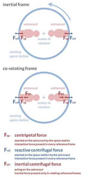

A.T. said:
It is the interpretation of Newton's third that you will find in every modern physics book. It doesn't matter how you call this Law ("3rd law" or "generalized 3rd law"). All your hand waving cannot change the fact that:
- It is a law of physics.
- It states two equal but opposite forces.
- It applies to static cases too.
- It means that my astronauts exert a centrifugal reaction force on the station
We agree that there is a force exerted on the space station by the astronaut that is a reaction to the force of the space station causing the astronaut to experience centripetal acceleration. All I am saying is that that reaction force causes the space station centre of mass to undergo centripetal acceleration toward the centre of rotation. So the reaction to the centripetal change of motion of the astronaut is a centripetal change of motion of the thing that is acting on the astronaut. And that is what the third law says must occur.

A.T. said:
And you are wrong as usual. The space station centre of mass has no acceleration toward the centre of rotation. The space station centre of mass is static at the centre of rotation.
Are you including both astronauts in the space station? The space station I refer to includes only the other astronaut. Read my #136 post:
"With respect to the astronaut space-station example, the third law says that a body undergoing centripetal change in motion due to contact with another unimpeded body causes that other body to have an equal change of motion in the opposite direction. So if we are talking about the astronaut undergoing a centripetal change in motion due to contact with the space station/other astronaut (taken as one body), the third law "reaction" is a change in motion of the space station/other astronaut in the opposite direction. That change in motion always points to the centre of rotation."​
Here is a simple question: If the reaction force to the centripetal acceleration of astronaut 1 is a centrifugal static force (ie it does not result in any contrary change in motion of the thing that is accelerating astronaut 1) what is the force that causes the centripetal acceleration of the centre of mass of the space station/other astronaut?
Needless to say that even if you were right, it would be still irrelevant. It would not change the fact that the contact force Frcf acts centrifugally on the wall.
We agree on the force and we agree on the direction. And all I am saying is that since this force causes the rest of the mass to which the astronaut is connected to undergo acceleration toward the centre of rotation, it is a true centripetal force. Calling it centrifugal is a misnomer.

Andrew Mason said:
...acceleration...
Irrelevant. The force is there, regardless of acceleration. In the rotating frame there is no acceleration at all, but there still is a force on the wall pointing outwards: centrifugal.

Sorry, you don't get to decide how people divide the system into parts. In my example there are 3 objects: station & 2 astronauts. This is a perfectly valid way to analyze the scenario. So deal with it, and don't try to change it.
I am not changing anything. Are you saying that the presence of the other astronaut does not affect the force that the space station applies to the first? Since it does, then you have to include it as part of the "other body" that is interacting with the first astronaut.
Every atom in that space station/2 astronaut example is accelerating. There are a gazillion tension forces. The total force on each atom is the atom's mass multiplied by its centripetal acceleration.

Yes you are. The definition of the objects is part of the example, to demonstrate reactive centrifugal forces. You don’t get to change my example, just because it proves you wrong.
Andrew Mason said:
There is an apparent force in the rotating frame.
And a real centrifugal force on the wall Frcf. It exists in every frame.
Andrew Mason said:
The real forces are causing accelerations toward the centre.
There is no acceleration in the rotating frame. It is all static. But there still is a real centrifugal force on the wall, exerted by the astronaut. Accelerations are irrelevant to this.
Ok. It is a centrifugal force that has as its only physical effect the acceleration of the centre of mass of the rest of the system toward the centre of rotation. Is that how you want to explain this to students?
It is rotating. Everything is accelerating. We use the inertial frame to analyse forces. The absence of apparent acceleration in the non-inertial frame is not real. Why are you even referring to this? This makes it very difficult for the student to distinguish between the apparent centrifugal force and the real reaction force (which you say is a static centrifugal force and I say is a non-static centripetal force).

Wrong and irrelevant. It can have other physical effects, like creating a dent in the wall. But the physical effects of the force are irrelevant to the fact that it acts centrifugally.

Yes, static. Nothing moves in the rotating frame of my scenario.
Andrew Mason said:
It is rotating.
Not in the rotating frame.
You were posting as I was editing. I added:
It is rotating. Everything is accelerating. We use the inertial frame to analyse forces. The absence of apparent acceleration in the non-inertial frame is not real. Why are you even referring to this? This makes it very difficult for the student to distinguish between the apparent centrifugal force and the real reaction force (which you say is a static centrifugal force and I say is a non-static centripetal force).​
We don't analyse real forces in the rotating frame.

There is no need for a reduction in the centripetal force in order to cause a dent. You are again taking one specific scenario and making a mistaken generalization.
Yes, we do. We also analyze fictitious forces there, but real forces are not ignored.

Who is "we"? I show the forces in both frames in the diagram.
