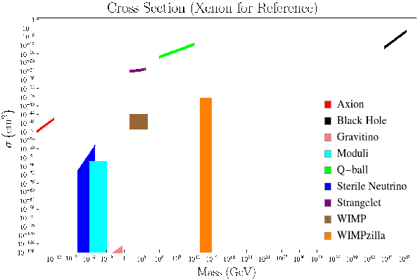

If you look at plots like this one
(From http://arxiv.org/abs/arXiv:1310.8642)
The WIMP is only one tiny region in the mass vs cross section plane. There are many other candidates remaining and I think this graph is not complete either.
Wait, they were expecting black holes to show-up in the detectors :oldconfused:
No. You are misinterpreting. This is a graph of candidates and, as I said, the detector was constructed explicitly to look for WIMPs (the brown region). My entire point was that there are many other candidates that would not show up in the detector.
Ah, ok. I thought maybe micro-black holes or something lol.
For comparison, the LUX experiment could have detected dark matter with cross section potentially as low as about 10^{-45}cm^2, in a mass range from roughly 1GeV to 1000GeV. That barely touches the top left of that brown rectangle.
