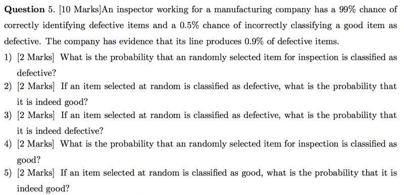

The problem statement is given below:
Text of Question 5 (10 marks) on inspector classification probabilities, with five numbered sub-parts asking for probabilities of defective and good classifications.

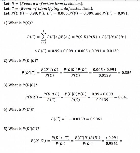

Here is my attempt so far:
Worked probability solution showing P(C) = 0.0139, P(D'|C) = 0.356, P(D|C) = 0.641, P(C') = 0.9861, and an unfinished setup for P(D'|C') using P(D'∩C') / P(C') with 0.991 and 0.9861.
I'm sure questions 1 - 4 have been answered. Question 5 is what concerns me.
I need to find ##P(C' | D')##, which is the probability a good item is identified, given a good item is chosen.
The probability a good item is chosen is ##P(D') = 0.991##.
Now I need the probability the good item chosen is identified as a good item. From question 4), the chance a good item is identified is ##P(C') = 0.9861##.
Would that mean of the ##99.1##% of good items, ##98.61##% of them will be identified as good items? So we would get:
$$P(C' | D') = 0.991 * 0.9861 = 0.977$$
I am not confident about this. Any help would be appreciated.
Thank you.

Your answers to 1-4 are correct. Except you missed a digit on 3. The answers to 2 + 3 must equal 1.
Yes there was precision error when using my calculator. 0.36 + 0.64 = 1 if we round everything nicely.

I usually find it much easier to solve such problems by using a more informative and more "immediate" notation, such as G = part is good, CG = classified as good, D = part is defective, CD = classified as defective. So, you are given P(D) = 0.9% = 0.009, P(CD|D) = 99% = 0.99 and P(CD|G) = 0.5% = 0.005.
You want (1) P(CD), (2) P(G|CD), (3) P(D|CD), (4) P(CG) and (5) P(G|CG).

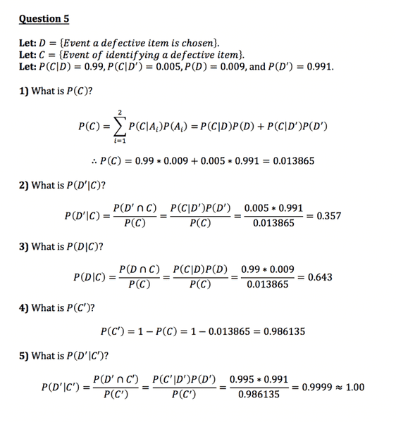

Aside from being a bit hard to follow (just because of notation) your formulas seem OK. However, some of your numerical answers are a bit off, due to premature roundoff:
(2) should be 0.35737 ≈ 0.357 (not your 0.356), (3) should be 0.64263 ≈ 0.643 (not your 0.641). I recommend you either do exact rational arithmetic and round off at the end, or keep a few more significant figures during the computations themselves, and again, again round off at the end.

Here is the solution with the precision taken into account:
Handwritten-style solution to a conditional probability problem with defective items, showing P(C) = 0.013865, P(D'|C) = 0.357, P(D|C) = 0.643, P(C') = 0.986135, and P(D'|C') = 0.9999 ≈ 1.00.
I'll refrain from rounding off too early.
