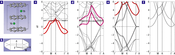

May be the most mass produced superconductor in future: graphite?
Let us see:
MgB2 and graphite are very similar in electronic structure
see the book: Electronic structure: basic theory and practical methods / Richard M. Martin. 2004
The simple hexagonal form of graphite
consists of these planes stacked with hexagons over one another in the three-dimensional
simple hexagonal structure, Fig. 4.2. This is also the structure of MgB 2 which is illustrated
in 4.6. The boron atoms form graphene-like planes in the simple hexagonal structure and
the Mg atoms occupy sites in the centers of the hexagons between the layers. Since each
Mg atom provides two valence electrons, the total electron valence count per cell is the
same for graphite and MgB2. Thus we can expect the band structures to be closely related
and the bands near the Fermi level to be similar.

As we can see MgB2 and graphite also obey Chapnik-Kikoin rule. But!
It may be very usefull to experiment with doped graphite so as to get Fermi level cross (a little bit) sigma graphite band, to get sigma band in graphite partially unoccupied and get hole conductivity (positive Hall coefficient). Graphite can absorb many gases and liquids.
Sigma band is stronger in graphite, than in MgB2 so we can hope to get Tc more than 39K.
It would be very interesting to test the Chapnik-Kikoin rule for "doped" graphite. May be we have a chance get from unsuperconductive graphite superconductive one.

Graphite-like superconductors are already obtained:
T.E.Weller et al., Nature Phys. 2005, 1, 39
C6M (M = Yb or Ca).
and
http://www.nature.com/nphys/journal/v1/n1/full/nphys135.html
Tc is about >10K
Who knows where can i get band picture for invented "doped" graphite? Hall coefficient?
http://www.nature.com/nphys/journal/v1/n1/fig_tab/nphys119_F1.html
See Г A region!
